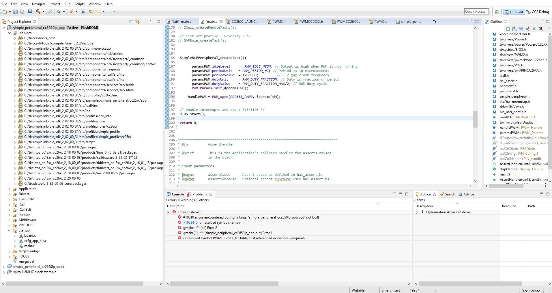

 I have deleted my older CCS and installed the latest version. However, when I try to import example projects from BLE-SDK 2.20 , I get many errors. No matter which project I import (they are all from BLE-SDK ver 2.20 examples folder), I always get the the same errors. What might be the reason ?
Here are my instalation details;
ARM Compiler Tools Version: 15.12.3.LTS
TI RTOS for CC13xx and 26xx version: 2.20.0.06
CC26xx Device Support Version: 2.0.0.00
I have attached a screen shuts below.
Many thanks

    If you looked into the software developer's guide more carefully, you will see
    1. You need to use TI-ARM compiler version >=5.2.6
    2. The TI-RTOS version should be 2.18 instead of 2.20.
    Can you make sure at least what I pointed out are corrected?

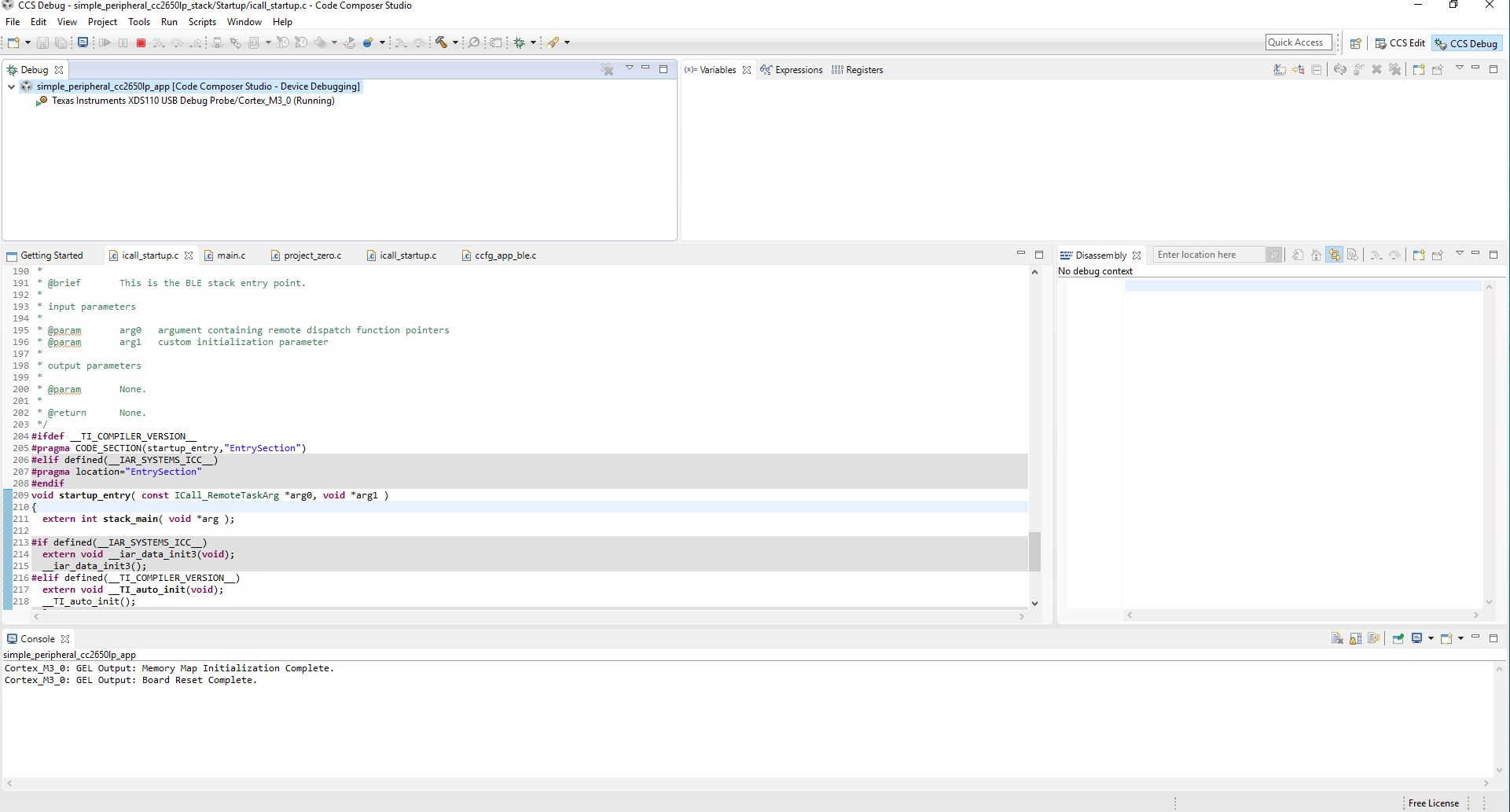

    Now I have another problem, I succesfully compile and download the code but the resume and suspend buttons on the debug window are not active. Only the terminate button is active. When I press the terminate button it somehow stops and other two buttons become active. But it is not running the code, I can never get in main and execute the code line by line.
    Do you have any idea about this issue ?
    many thanks

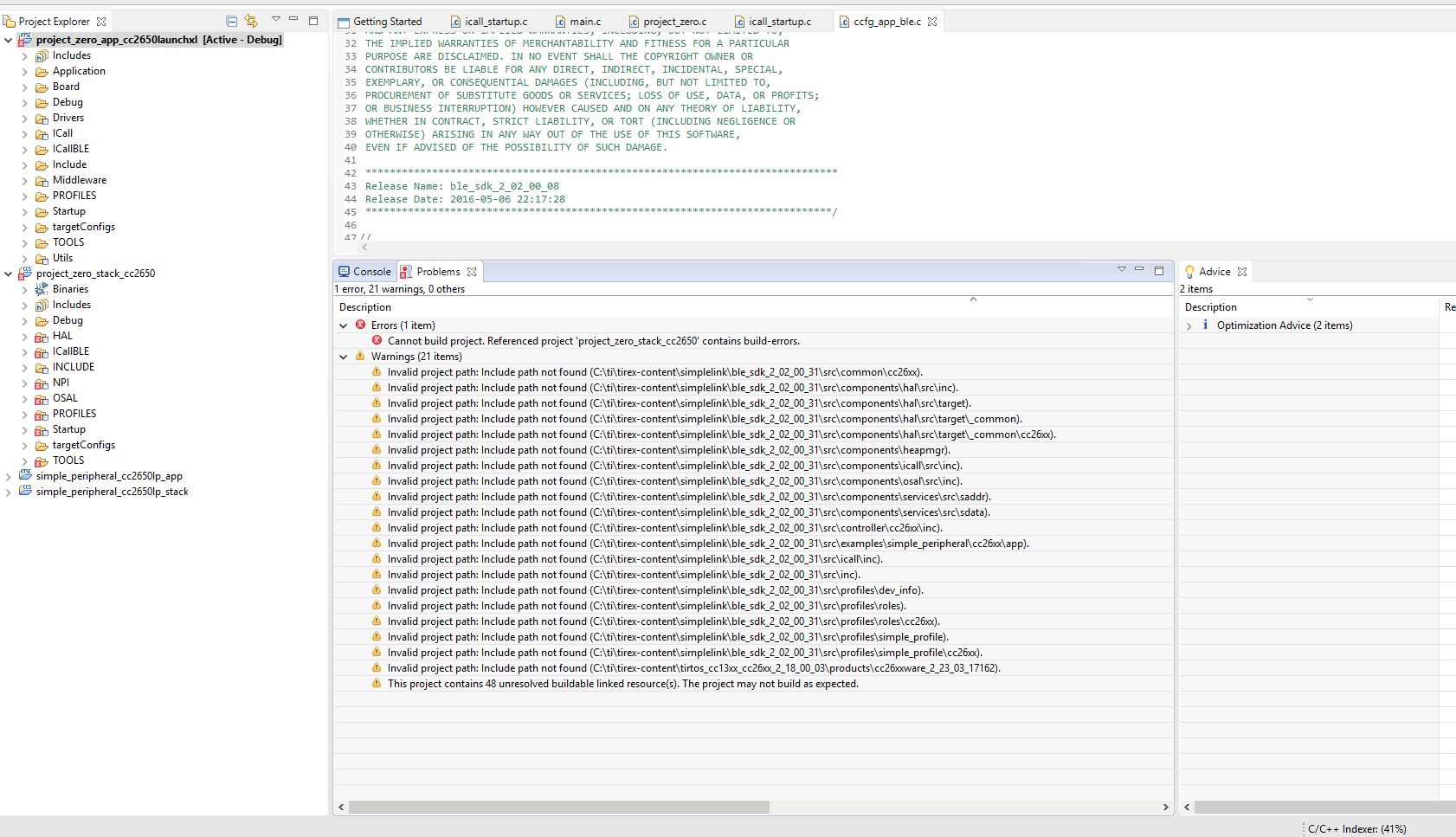

  • I have removed everything (that I manually copied inside tirex folder as CCS was warning me about some invalid project path) inside tirex folder and this is what I am getting now ;
    Many thanks,
  • You imported the project zero from CCS cloud/simplelink academy right?
    For simplelink academy to work on CCS 6.2, you do need to manually copy the TI-RTOS into tirex folder. We are working on fixing this now, sorry for the inconvenience.
    However, for simple_peripheral which comes from BLE stack 2.2, you should not need to copy TI-RTOS into tirex folder.

    For the simple peripheral example under ble-sdk 2.2 folder, no error generated after I deleted tirex folder. However, when I downlaoded the code to Launchpad, the resume and suspend buttons are not working as can seen below ;
    Do you have any idea why buttos are inactive ?
    Many thanks
  • Thanks for letting us know. We have seen that problem and found a solution. There will be a ccs update later tonight which fixes the problem.
  • Actually in ccs forum, they are already providing the fix there. If you can't wait for the software update, the please go to :

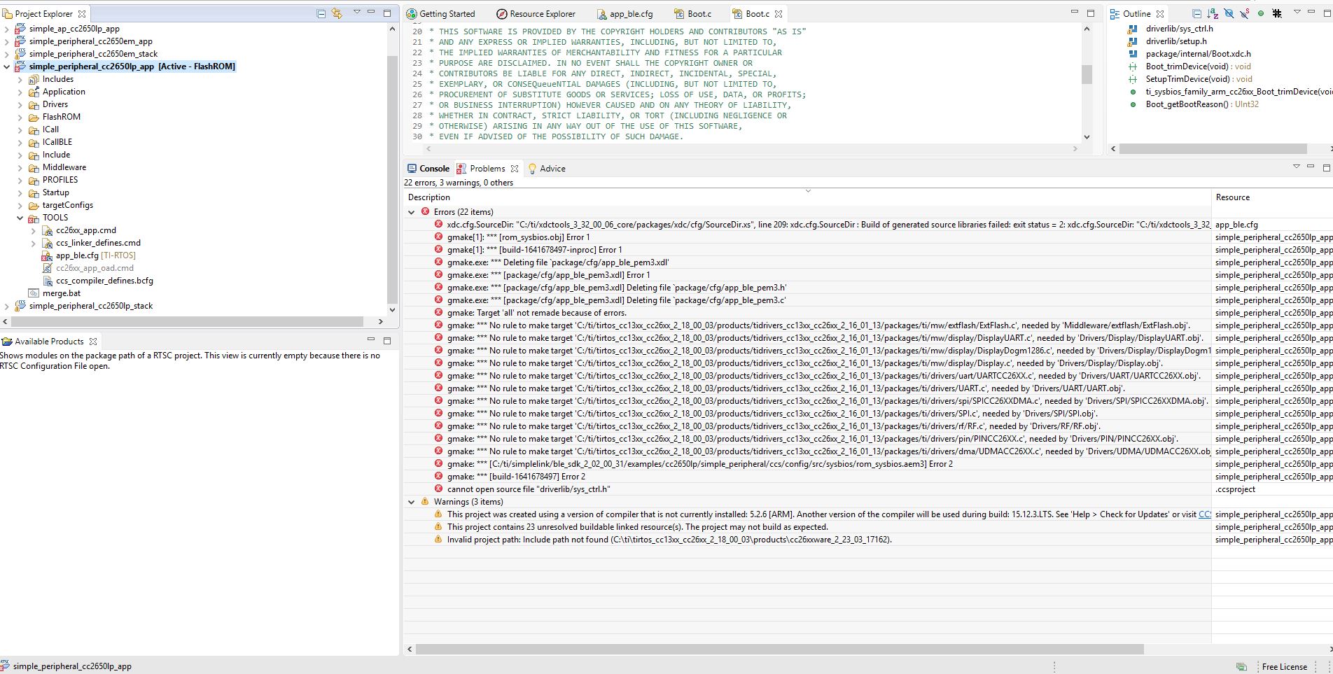

    I have updated it, now the example project runs well. However, when I add the pwm drivers to TI-RTOS 2.18's driver folders. I am getting error like this ;
    What is the reason ? I am using BLE-SDK 2.02 simple_peripheral example. I just added PWM2.h , PWM2.c, PWMCC26XX.h, PWMCC26XX.c and GPTimerCC26xx.h, GPTimerCC26xx.c files to driver folders as told in pre-release pwm library guide (e2e.ti.com/.../474000)
    I have also made all the configuratinos being told in that site but still getting errors..
    Does it have to do with RTOS version ? I want to use the official release of pwm library for TI-RTOS 2.20 but simple_peripheral example for BLE-SDK 2.02 does not work with TI-RTOS 2.20, I am stuck with this and really driving me crazy. How can I get this working ?
