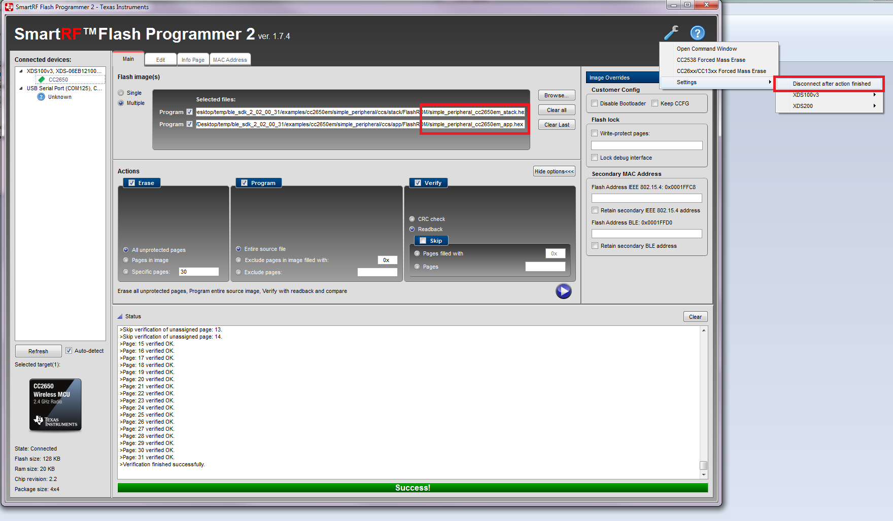

    Did you make sure to reload both the stack and the app project onto the board after making those changes?
  • Yes, I did. I re-built the stack, flash erased the board and re-programmed the board with both the app and stack. I looked at power cycling the board following this.

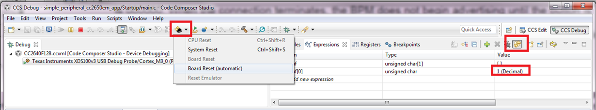

  • The code implemented verbatim from the software developer guide is getting incremented more than once on the 2650 DK. After each power cycle the stored byte jumps up by 3. Let me know your feedback.
    Thank you,
    Priya
  • Hi Priya,
    I tested the following code using both OSAL_SNV=1 and OSAL_SNV=2 and found it to work. Please insert the following code into your simple_peripheral.c file.
    #define BUF_LEN 1
    #define SNV_ID_APP 0x80
    uint8 buf[BUF_LEN] = {0};
    Insert the following into SimpleBLEPeripheral_taskFxn():
     // Initialize application
      SimpleBLEPeripheral_init();
      uint8 status = SUCCESS;
      //Read from SNV flash
      status = osal_snv_read(SNV_ID_APP, BUF_LEN, (uint8 *)buf);
      if(status != SUCCESS)
          //Write first time to initialize SNV ID
          osal_snv_write(SNV_ID_APP, BUF_LEN, (uint8 *)buf);
      //Increment value and write to SNV flash
      buf[0]++;
      status = osal_snv_write(SNV_ID_APP, BUF_LEN, (uint8 *)buf);
    Put a breakpoint at line 14 in the above code and watch how the variable changes through a reset. Does it still increment by 3?
  • Rachel,
    I have been using BLE stack 2.2 with CCS 6.1.2. When I power cycle, I terminate the CCS
    run first and start over. I will try try turning the switch on and off without halting CCS.
    The code copied from the stack document advertised for osal_snv = 2. I tried this once but
    the variable seemed to be incrementing the same way as for osal_snv=1. On Monday
    I will try again with BLE stack 2.1 as well.

    Rachel,
    I cut and pasted your code into a clean copy of simple_peripheral and tried it out on the CC2650 4x4 DK for both BLE stack 2.1 and 2.2. I am using osal_snv=1 and I have the nvocop.c edit in both versions of the stack.
    The code behaves the same way. I start with buf[0] = 0. When I power cycle, I expect buf[0] to start out at 1. Instead it starts out at 3. The next time, it starts out at 6 and so on. It does not seem like buf[0] is being incremented more than needed during the application. Something appears to happen during the power cycle.
    I will have our software person also look at this when he comes in this week. Maybe the code will work as expected for him. I have attached the simple_peripheral.c (BLE 2.2) and simpleBLEPeripheral.c (BLE 2.1) files to this post.
    Thank you,
    Priya
  • Hi Priya,
    This could be caused by the method you are using for power cycling. Instead of doing a full power cycle, you can do a Board Reset in CCS. I pasted your simple_peripheral.c code into my CCS project and was able to observe the buf[0] variable increasing by 1.
    I'm including a screenshot below showing how I am resetting the board. I also have the Continuous Refresh option selected in my Expressions window so I can see the buf[0] variable change without pausing my program.
    The first time the program is run, the value stored in buf[0] changes to 1. The value increments by 1 after every Board Reset.
  • Rachel,
    The board reset from CCS helped. The incremented byte is being re-loaded correctly.
    When I try to view the expression buf[0], I don't see any value displayed for buf[0], only an address. Clicking on the continuous refresh did not change anything. Maybe having the System_printf to Sysmin prevents this display.
    I appreciate your help and time in answering each of my questions.
    Thank you,
    Priya

  • Hi Priya,
    Now that we have seen the code work correctly in CCS, you can try running without using the debugger and displaying the output to a terminal window. I ran your code using SmartRF Flash Programmer and read the values that were being stored in the memory after toggling the power switch on the SmartRF06 board. I never saw a jump by more than 1. Here is my setup:
    1. First, flash the stack and app images using the settings shown below. Make sure to uncheck the "disconnect after action finished option" in the wrench->settings menu.
    2. Switch to the "Edit" tab and read page 30. The first read should show FF followed by all 0's.
    3. Toggle the power switch on the SmartRF06 Board. Reselect the CC2650 and read from page 30 again. You should see something similar to the image below. The blue boxes represent the header (ID-80, offset-4) and the data (00) from the write initializing the SNV ID. The green boxes represent the header (ID-80, offset-4) and the data(01) from the second write.
    4. Toggle the power switch again following the procedure in step 3 and you will see a new write showing the value 02 in the data byte that is 4 bytes away from the ID.
    This should give you an accurate representation of what will happen in the field. Please let me know if you have any additional questions.
  •  Rachel,
    I followed the steps you had outlined. I am finding 3 bytes changing as I read from flash page 30. How do I know to go to page 30 to read SNV id x80? I am unable to upload the hex files I used on the forum, I am happy to email them to you. I am attaching a screenshot of the flash read. I thought only one byte location will keep getting read from and re-written, but many bytes in the flash memory are being written to.
    Thank you,
    Priya
  • Hi Priya,
    If you look at Section 3.10.1 of the TI BLE Software Developer's Guide, you can see the Flash Memory Map for the CC2650. The SNV area is written at the end of the stack. Page 31 is reserved for the CCA so for one page SNV, page 30 is used for the SNV. For 2-page SNV, page 29 and 30 are used.
    If you step through the writeWord in nvocop.c file, you can see how the SNV data is written. The data you are writing is tied to the header id and length. You can read your map using the template I provided above but it looks like your SNV is working correctly. Only the most recent data tied to the id you are using (0x80) is valid. For more information, please read through Section 3.10.3 of the TI BLE Software Developer's Guide.
