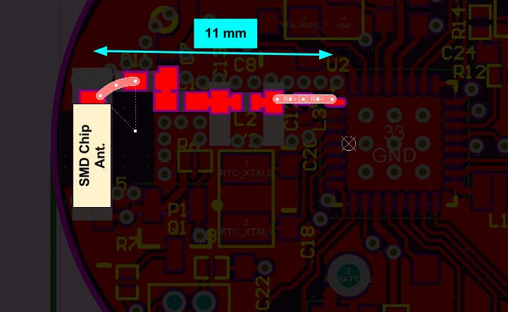

Hello again,
I have a question about the antenna config. As described, there is a #define
#define RF_FE_MODE_AND_BIAS           ( RF_FE_SINGLE_ENDED_RFP |  RF_FE_INT_BIAS ) // RF_FE_DIFFERENTIAL
in the ICallBLE -> bleUserConfig.h
It seems for me this does not have an effect to our implementation. I cannot find out where this setting is used in the project or c files.
So, is this the right setting?
What is the meaning of this in bleUserConfig.c
// Differential Output
// ALT: Consider basing this direction on type of output (RF_FE_MODE_AND_BIAS)?
// Tx Power Values (Pout, IB, GC, TC)
const txPwrVal_t txPowerTable[] =
{ { TX_POWER_MINUS_21_DBM, GEN_TX_POWER_VAL( 0x07, 3, 0x0C ) },
{ TX_POWER_MINUS_18_DBM, GEN_TX_POWER_VAL( 0x09, 3, 0x0C ) },
{ TX_POWER_MINUS_15_DBM, GEN_TX_POWER_VAL( 0x0B, 3, 0x0C ) },
{ TX_POWER_MINUS_12_DBM, GEN_TX_POWER_VAL( 0x0B, 1, 0x14 ) },
We got a very poor communication range and very low (-75dB) level on a distance of 20cm.
Are there some hints?
