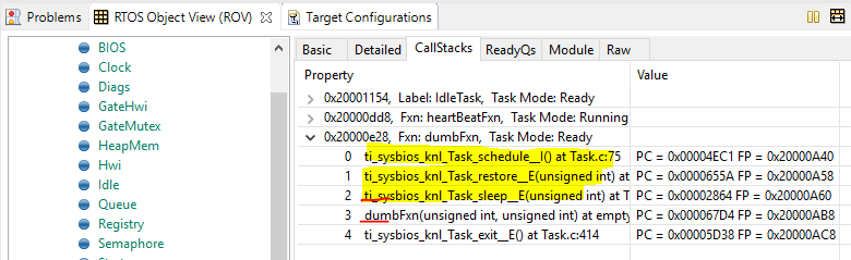

  • Let me specify exactly what I want to do: In the exception handler I want to get the value of the crashing thread's PC value, as well as the PC value of any other thread in the system and save it to the no_init region.
  • Hi Ali,
    I don't think that is going to be fun. But I suppose it is possible. The best I can do for you right now is,
    * Add the precompiler symbol ti_sysbios_knl_Task__internalaccess
    Then do something like this:
    Task_Object *taskList[] = {(Task_Object *)&task0Struct, (Task_Object *)&task1Struct};
    Task_Stat taskStats;
    int i;
    Task_Object *pTask;
    for (i = 0; i < sizeof(taskList)/sizeof(taskList[0]); ++i)
    	pTask = taskList[i];
    	Task_stat(pTask, &taskStats);
    	System_printf("Task fxn: %08x -- ", pTask->fxn);
    	System_printf("context: %08x\n", pTask->context);
    System_flush();
    If you use CCS, then it should autocomplete for you when you write pTask->, and show you what exists. You can also look at Task.h to see the struct.
    This will give you the context pointer. That is to say, the stack pointer. From there you can probably work your way down the stack to see what function was the last one.
    The problem is that TI-RTOS will add some functions at the top of your real last function/PC. See the picture below. I don't know how to interpret the stack frames and figure out what was really going on.
    Aslak
