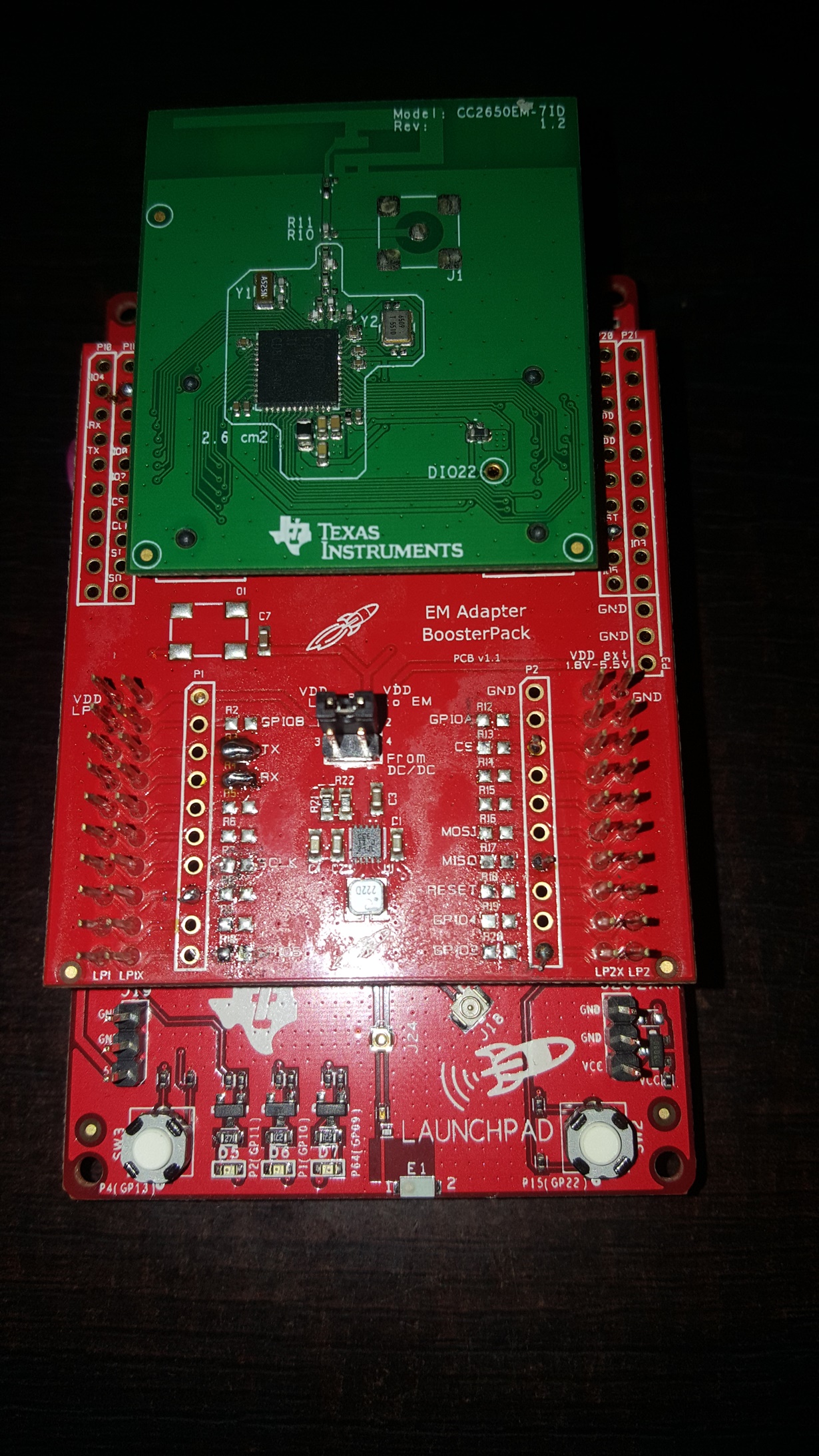

As mentioned in the link, we setup the hardware as below-

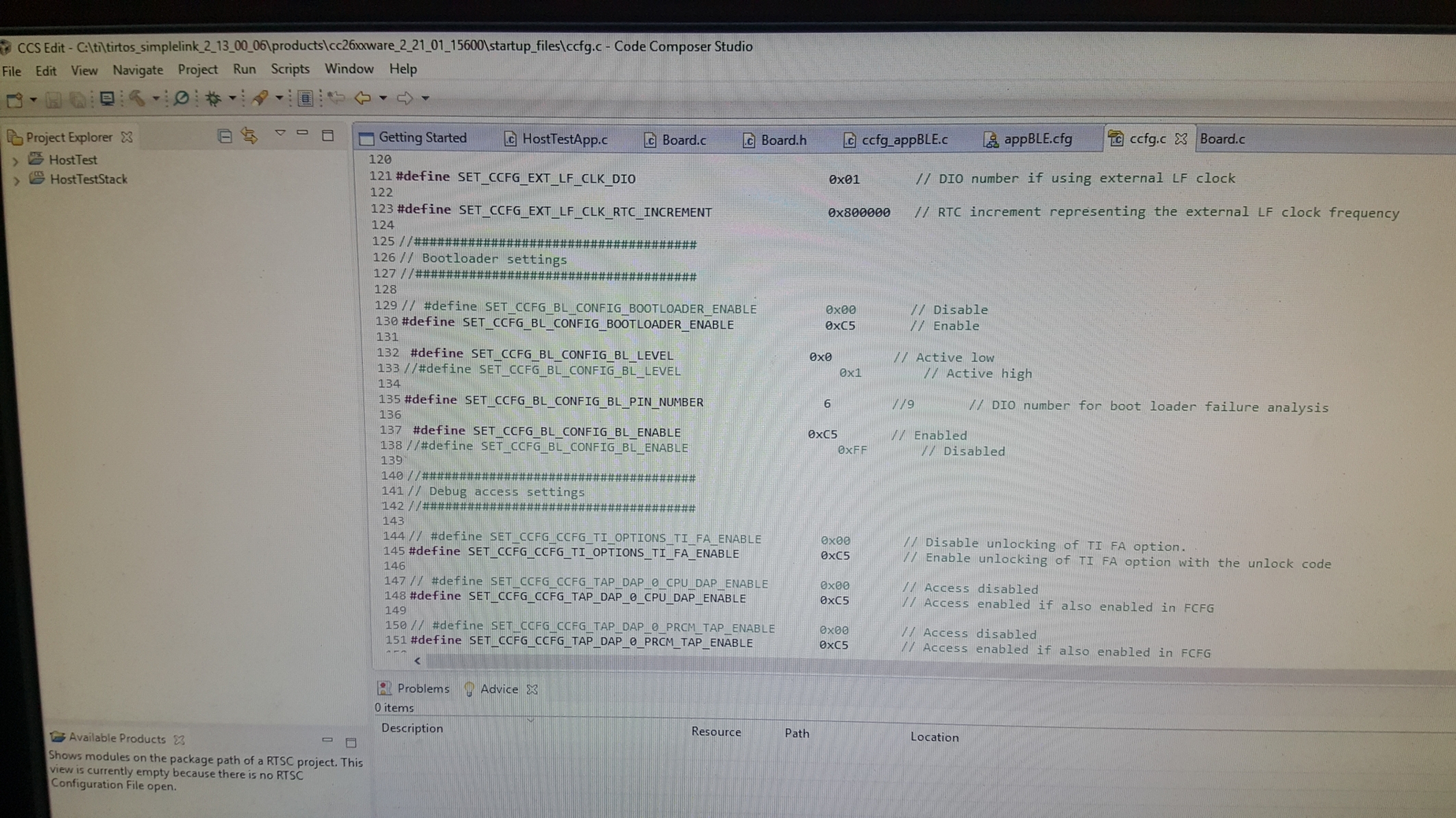

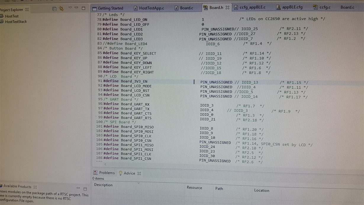

As described, I'm using host test App/Host Test stack to build  cc26xx.em7id.sbl06.bin .In board file & ccfg.c ,we changes pins as below-

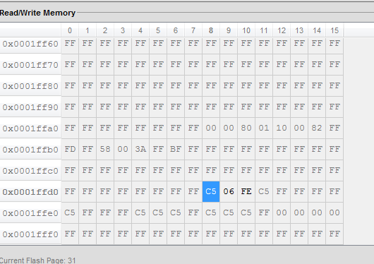

Also, I changes the Configuration resistor  0x1ffd9 to be set to '06' instead of '03'. as below -

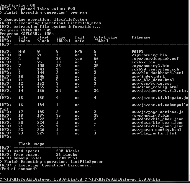

Now, I'm trying to flash CC3200 LaunchPad for UART programming mode (connect J15 (SOP2=1), remove J16 (SOP1=0), remove J17 (SOP0=0)). Its flashing as below but i 'm not able to run the gateway after that.
