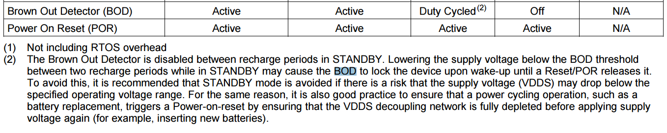

    I am giving 3V as VDDS to cc2640 and  then i intentionally short that 3V with ground using jumper wire.Due to that shorting the device stops working, that is understood.But what would be the state of the device if after i remove the shorting, will it be working again?
    My observations are, sometime the device resets and start working and sometimes it is hung-up. I aslo have seen that the supply rail of 3V has been held at 1.8V by cc2640.

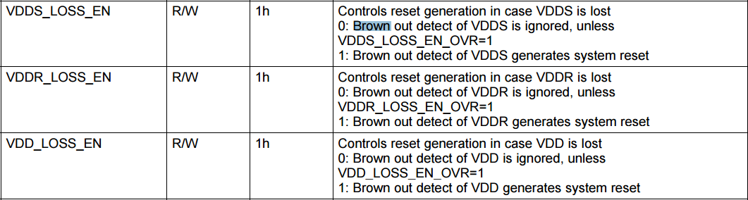

    And we can ignore the Brown Out Detection, configuring the RESETCTL register. I am wondering if  ignoring the Brown Out Detect will make any difference in such shorting issues.
