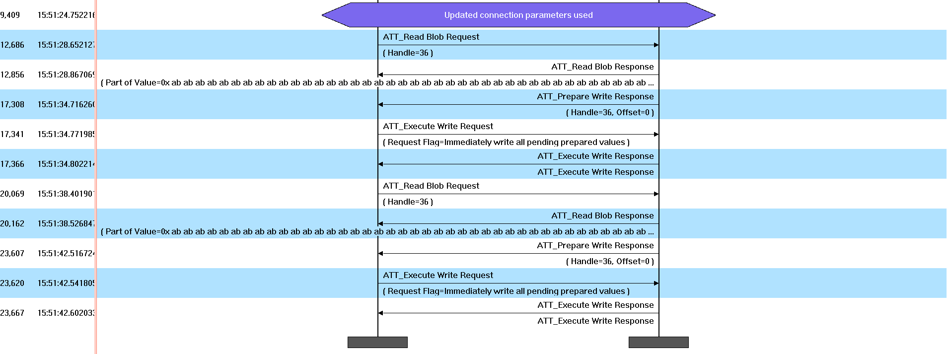

Hi TI Support Team,
I am working with CC2640 and using 2_18_00_03 BLE stack. I am currently using SmartRF06EB+CC2650-7ID as aplatform for developing the firmware.
I have started by working with Simple_BLE_Peripheral project and using BTool + Host_test_app as central to test the firmware. I am trying to use Write Long Characteristic GATT command to send 200 bytes to the peripheral. I can read the long characteristic which is initialized to some value. But when i try to write i get an error saying INVALID_SIZE. I also get an info message from BTool saying the device limit to write is 90 bytes. I would like to know whether this is a CC2650 limit or Host_test_app firmware limitation or the limitation of the BTool. Please let me know what is limiting the scenario and what to change to get a 200 byte write. I am attaching the BTool Log.
I would like to have a response soon. I have had bad reviews about TI support dragging its feet for no reason. Please help me prove that it is incorrect.  I have already tried to search the forum but i could not find a satisfactory answer.

[292] : <Info> - 10:49:30.539
GATT Write Command Data Length Exceeds Device Write Limit
Command Data Length = 200
Device Write Limit = 90
Multiple Write Commands Will Be Used To Send The Data
[293] : <Tx> - 10:49:30.539
-Type           : 0x01 (Command)
-OpCode         : 0xFD96 (GATT_WriteLongCharValue)
-Data Length    : 0x60 (96) byte(s)
 ConnHandle     : 0x0000 (0)
 Handle         : 0x0024 (36)
 Offset         : 0x0000 (0)
 Value          : 11:22:11:22:11:22:11:22:11:22:11:22:11:22:11:22:
Dump(Tx):
0000:01 96 FD 60 00 00 24 00 00 00 11 22 11 22 11 22 ...`..$...."."."
0010:11 22 11 22 11 22 11 22 11 22 11 22 11 22 11 22 ."."."."."."."."
0020:11 22 11 22 11 22 11 22 11 22 11 22 11 22 11 22 ."."."."."."."."
0030:11 22 11 22 11 22 11 22 11 22 11 22 11 22 11 22 ."."."."."."."."
0040:11 22 11 22 11 22 11 22 11 22 11 22 11 22 11 22 ."."."."."."."."
0050:11 22 11 22 11 22 11 22 11 22 11 22 11 22 11 22 ."."."."."."."."
0060:11 22 11 22                                     ."."
[294] : <Rx> - 10:49:30.602
-Type           : 0x04 (Event)
-EventCode      : 0x00FF (HCI_LE_ExtEvent)
-Data Length    : 0x06 (6) bytes(s)
 Event          : 0x067F (1663) (GAP_HCI_ExtentionCommandStatus)
 Status         : 0x00 (0) (Success)
 DataLength     : 0x00 (0)
Dump(Rx):
0000:04 FF 06 7F 06 00 96 FD 00                      .........
[295] : <Error> - 10:49:30.929
ATT Command Failed
Command = ATT_ExecuteWriteReq
Handle = 0x0024
Error = The Attribute Value Length Is Invalid For The Operation.
[296] : <Rx> - 10:49:30.929
-Data Length    : 0x0A (10) bytes(s)
 Event          : 0x0501 (1281) (ATT_ErrorRsp)
 PduLen         : 0x04 (4)
 ReqOpCode      : 0x18 (ATT_ExecuteWriteReq)
 ErrorCode      : 0x0D (13) (INVALID_SIZE)
                  For The Operation.

  • Coming back to this, I did some further research and identified that there is a 90 byte write limitation in BTool if you are initiating the write from the Read/Write tab. There is no limitation if you are using GATT_ReadLongCharValue from the Adv. Commands (GATT) menu.
    Also, on your peripheral (GATT server) side, be sure to set the Prepare Write Queue to match the expected number of bytes you expect to receive, The default queue size is 5, which at the default MTU of 23, is 5 * 18 bytes = 90.
    You can adjust the Prepare Write Queue with GATTServApp_SetParameter with param GATT_PARAM_NUM_PREPARE_WRITES. There is no specified limit, but you are bounded by available HEAPMGR space.
    Best wishes
  • Thanks that clears out some of my questions. I was not using the read/write tab i am using the GATT_WriteLongCharValue from the Adv. Commands (GATT) menu to write 200 bytes to my server.
    I have already changed the GATT_PARAM_NUM_PREPARE_Writes to 20 and there was no problem with the HEAPMGR space.
  • Here's the current log that i have after i updated my code on the peripheral.

  • Hi JXS,
    Now i am trying to use Simple BLE Central to read and write the 200 byte long attribute. I configured the central for data length extension and MTU size is updated to 206 bytes and it shows on the LCD. Now when i try to read the value from the peripheral I am able to receive ATT_READ_BLOB_RSP but when i try to access the last data byte i get incorrect value. Please let me know if I am doing something wrong here. I am able to read and write using my Iphone and using Btool but i cannot read using BLE Central firmware.
    Display_print1(dispHandle, 7, 0, "Read rsp: %d", pMsg->msg.readBlobRsp.pvalue[199]);
  • Hi Krutarth,
    With a packet sniffer, are you able to confirm if the value is correctly sent?
    Best wishes
  • Above image is a snapshot from my BLE Protocol Analyzer where you can see the response from the Peripheral when Central requests data.
