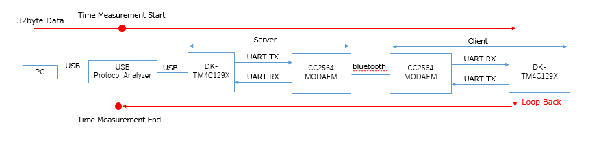

Please tell us about the CC2564 transfer time.
○Measurement environment
 HW : Client [DK-TM4C129X, CC2564MODAEM] , Server [DK-TM4C129X, CC2564MODAEM]
 SW : CCSv6.2, Stack v1.2 R2(SPPDemo), ServicePack v1.5
 Profile : BT SPP
○Method of verification
 1. 32byte data transfer from PC
   2. USB Protocol Analyzer Time measurement
 3. Data transfer from the server to the client
 4. Data loop back on the client side
 5. USB Protocol Analyzer Time measurement End
○Check Result
 It takes about 40mS in END from the time measurement Start.
○Question
 1. Does this transfer rate would be the specifications?
 2. In order to increase the its transfer rate, is there any way?

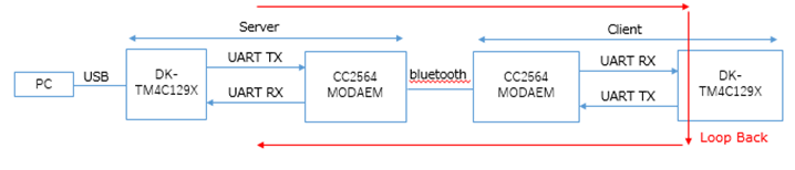

    I was re-measured to change the connection method.
    ●Connection method
    ●Confirmation method
    ・32bit data transfer from PC (on Teraterm)
    ・We measured the time in the following point.
    (1)Server UART TX ---- Client UART RX
    (2)Client UART RX ---- Client UART TX
    (3)Client UART TX ---- Server UART RX
    (4)Server UART TX ---- Server UART RX
    ●Check result
    (1)about 5.6mS
    (2)about 1.5mS
    (3)about 27mS
    (4)about 35mS
    ●Qestion
    I am sorry,I hope the immediate answer.
    hamada
  • This transfer rate is dependent upon the host (MCU) speed and the baud rate of the UART between Host and the CC2564. This is not part of the BT specification since large part of this is HW/UART peripheral dependant. Since this data is transferred over the SPP profile, it will be parsed at different layers of the BT stack. The processing required for this parsing adds little bit to this time.
    Increase the HCI baud rate between the MCU and the CC2564 will help reduce this time. The CC2564 can support as much as 4Mbps.
    Vihang
