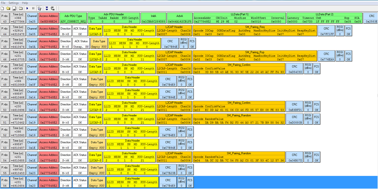

I want to do "just works" pairing with bonding but i didn't even arrive to do "just works" without bonding.

first picture is this one : start connection+ start pairing
Second picture : pairing failed, no security enabled
  • The error response you are pointing to does not relate to pairing at all. It is the response to the previous ATT_Find_By_Type_Value_Req. Can you attach the entire sniffer capture?

  • Ok, understood, maybe because there is discrovery of a characteristic that doesn't exist in the peripheral side. But , why there is no encryption ? i must see security enabled in the packets . i don't know how attach , but there is no difference, that 's exactly waht in the pictures. and i finished sniffing after it , because they are the same packets after that

  • Ok, i find the problem. It's not related to the stack it a mistake in the code. When i implemented my process, i forget to add an "else" :

    simpleBLECentral_HandleKeys(TRUE,HAL_KEY_UP); ====================> here an "else" is missed
    break;
    What i wanted is to restart scan in case there is no device found, so that means "else=if simpleBLEScanRes ==0" . Here so i retart scan after i establish link connection..it made a confusion to the system. I hope that helps the readers and guys may face such a problem.
