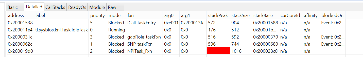

I downloaded and built the Simple Network Processor example from the SimpleLink Academy lab without any problems. However, when I installed it into the CC2650 LaunchPad, it seemed to crash. When I looked at the ROV, I noticed that two tasks GapRole and NPITask_Fxn had red stack peak fields. I managed to fix the GapRole stack by increasing the build flag to 600 instead of the default 520 value.
However, I was not able to fix the NPITask_Fxn stack problem by increasing it from the default of 602 (up to 1024).
As this is software straight out of the box, I was surprised to find this issue as it isn't mentioned anywhere in the lab. Can anyone suggest what might be causing this and how I might fix it ?

    I have attached some screenshots of the ROV Tasks and BIOS views (taken after I paused in debugger after a few seconds after startup) which may help :

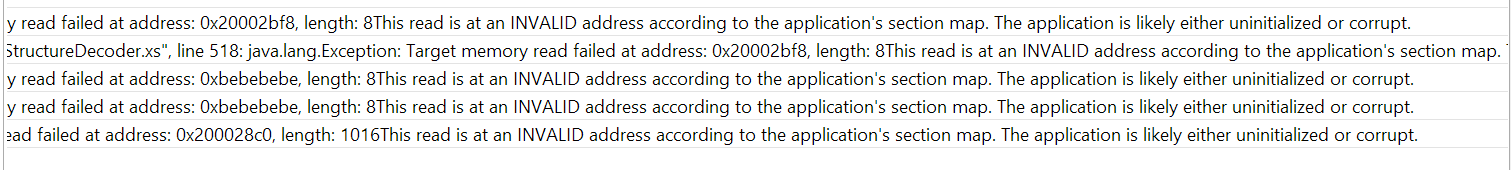

    Thanks for your suggestion. I have downloaded the compiler version 5.2.6 as suggested but it has not fixed the problem (although the issue with the GAPRole Task stack size didn't occur). See the attached screenshots for details:
    I also tried the newer SimpleLink Academy updated September 2016 (.09.00.0000) but this made no difference. Interestingly, the simple_np files which are under the SA directory aren't used in the example as the code comes from the BLE Stack example directory.
    So if the SA version, BLE Stack version, compiler version and TI-RTOS CC13xx/26xx versions are all as originally used, doesn't this mean that it can only be something about the new version of CCS (6.2.0.00050) and the ROV / debugger code?
    Do you have any comments on the errors that appear in the BIOS listing. Why should it think there are invalid read addresses in this example build ? How would changing the compiler version affect this especially as I don't get any build/compilation errors ?
    I will try to step through the code to determine where it fails, but I can't find any obvious issues in the map listing at these memory locations.

  • Hey Jeff,
    I ran into the same errors as you in regards to ROV. I verified that the NPI stack was not overflown (via memory viewer). There's plenty of space on my end. It's just the ROV utility that seems to be running into problems. To address this problem, I recommend posting this question on the TI RTOS forum: e2e.ti.com/.../355
    On the other hand, the SNP and  SAP projects included in the SDK need to be patched in order to function correctly. The SLA version is already patched, and work properly (and even have logging functionality to see where issues occur, saving you some code stepping.
    You mentioned using the SLA version of SNP and SAP - and did they work for you on 5.2.6?
    In regards to changing the compiler version, it's important to note it's influence on runtime stack/memory usage. Different versions of compilers will interpret the same code but produce different output files. Both will build, and have the same functionality, but how they achieve the functionality may differ (runtime memory useage, code size, etc). In this case, it sounds like you found that the stack size increased on the STS compiler, so I suggested using the one we test with. The heap and stack sizes for the examples were chosen with based on that compiler. (I hope that answers your question)

  • Hi -Rebel,
    Thanks for your response.
    It appears that the issue I am having is ROV-related. I also tried building and running the Simple BLE Peripheral example code and I get a similar message from the BIOS page about bad read memory access and Hwi/Queue issues. There are no task stack issues in that example.
    I will do as you suggest and post on the TI-RTOS forum to let them know of the issue. In the meantime I will try a different version of CCS to see if I can get it working. Neither of the examples I tried was able to run the BLE service or send log messages to Putty.

    • Turn off Drawf File Compression for ROV for the App project (right click -> properties -> build -> Arm Linker -> Advanced options -> Linktime optimizations)
    The ROV uses the drawf files to pull information, hopefully this will help it out. (I still got the errors on my end, but on other examples it allowed me to see all the RTOS tasks)

    I have reverted my CCS to version 6.1.3 and set the XDCTools version to 3.31.3.43 which seemed to remove an error in the simple BLE Peripheral example, but made no difference to the SNP example. I even reverted back to the earliest compatible XDCTools version for the 6.1.3 CCS viz. 3.31.00.24, but it didn't fix the issue of the memory read fail at address 0x20002a38.
    I did manage to debug further and found that the system fails with the ROV message when the NPITask_Fxn is created. If I create this task statically then the error message doesn't occur although the program fails during the SNP_initGAP function. It seems to get stuck in the first GAP_SetParamValue function for some reason. This appears to be in the sendWaitMatchCS function because the ICall_getEntityId parameter fails to return a valid entity ID.
    I also tried to use a Task_construct function instead of the Task_create function used in the NPITask_open function, but it makes no difference to the memory read address error.

    I also found on the Eclipse ROV bugzilla site a bug possibly related to this issue : bugs.eclipse.org/.../show_bug.cgi. It appears that ROV doesn't handle heap managers which add new memory address ranges and flags them as invalid and corrupt.

    I have just reverted my CCS back to 6.2 and am now using the latest compiler revision. I have set the GAPROLE_TASK_STACK_SIZE value (600) to adjust for the increase in size of the gapRole task stack to 516 with the new compiler.
    When I use the old version of the RTSC XDCTools (3.31.3.43) I don't get any ROV BIOS errors other than "Error fetching Hwi stack info!" messages which I have been getting all along.
    When I use the latest XDCTools (3.32.1.22_core) I now get extra semaphore errors :
    I guess I will use the latest version which doesn't cause me grief.
