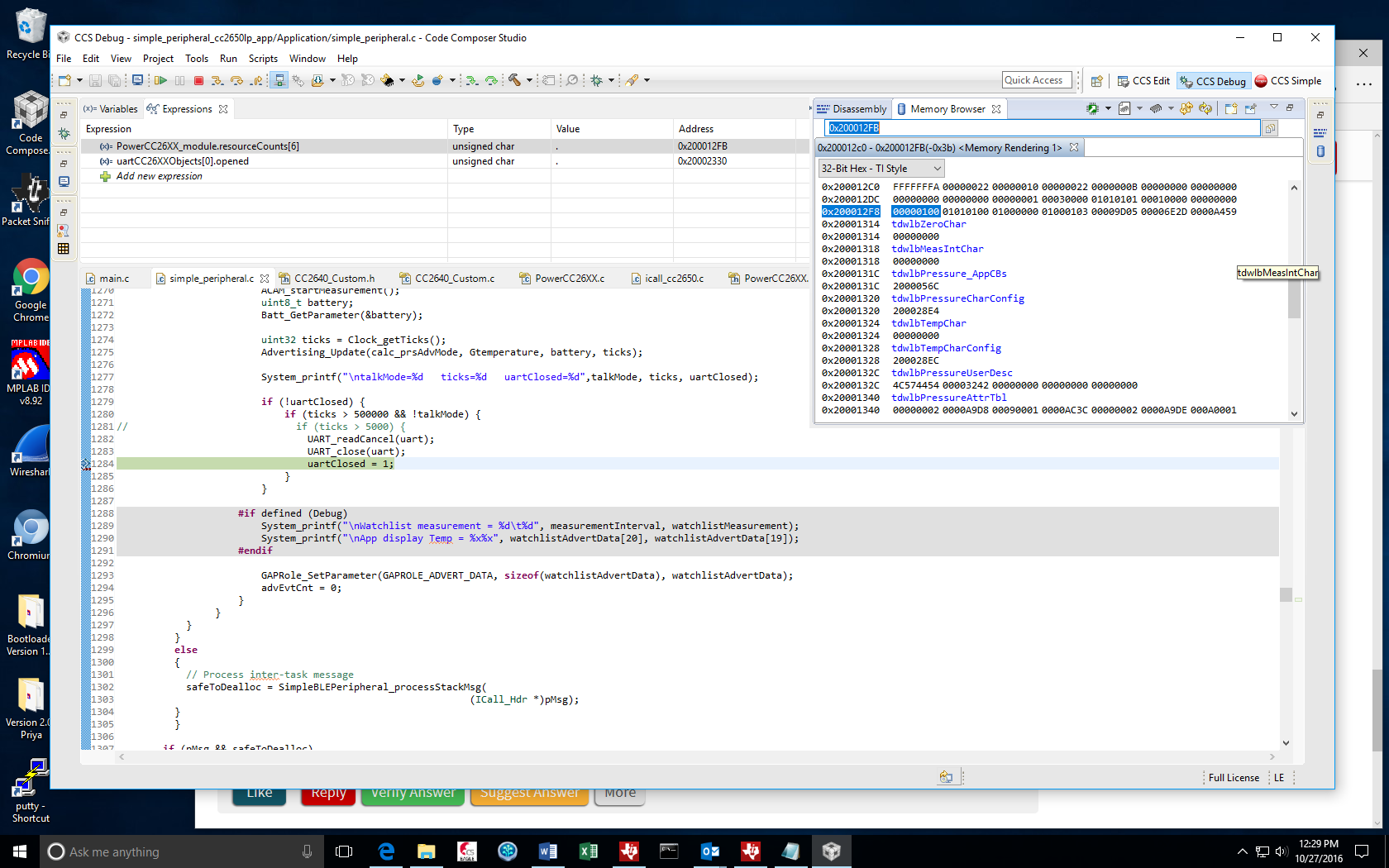

  • I characterized this scenario on the 7x7 DK this morning. I took a clean copy of simple_peripheral, added the UART driver to it in readcallback mode.  The only thing that the UART ISR does is to wait for the UART message. I closed the UART after 5000 clock ticks on the edge of an advertising event. I removed all jumpers from the DK and the current draw still measures 1mA. I left the default pin states in the 7x7 DK as they were originally defined.
    I have attached the simple_peripheral file I used to this post.
    Can you offer an explanation for why there is a current offset of 1mA even after the UART is closed?
    Thank you,
    Priya
    Let's see if the power driver thinks that a resource dependency is still in place - preventing the system from entering a low power mode. After closing the UART driver, please check the following structures via a watch window:
    PowerCC26XX_module.resourceCounts[PowerCC26XX_PERIPH_UART0]
    uartCC26XXObjects[0].opened
    Both of them should be 0 (or false). If it's not, then we know that the driver isn't releasing its dependency properly.
    Tom
  • Tom,
    I have attached screenshots of the watch window.
    It seems like PowerCC26XX_PERIPH_UART0   =  6.
    I am unable to view the contents of memory location 0x200012FB which is where
    PowerCC26XX_module.resourceCounts[6] is.
    uartCC26XXObjects[0].opened seems to be in memory location 0x20002330
    which is showing up as non-zero.
    Priya
