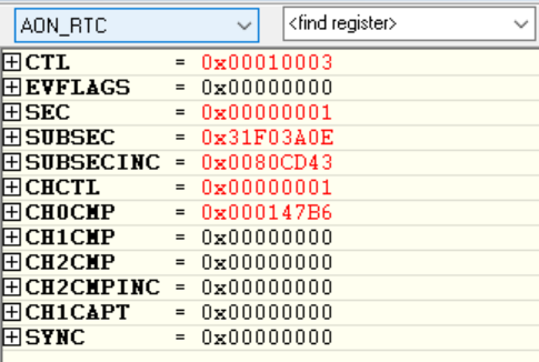

We are developing a custom hardware with CC2640 MCU and we are modifying Project Zero for our firmware. Referring the manual 'Running Bluetooth low energy on CC2640 Without 32 kHz Crystal', we would like to configure our software; however, the simple_periphal project was used in this manual and although it has FLASHROM_RCOSC as build configuration, Project Zero does not have that configuration. So what we need to change in Project Zero in order to work without 32 kHz crystal? Is adding rsocs_calibration.c file to Application and ccfg_app_ble_rcosc.c to Startup folders enough?
