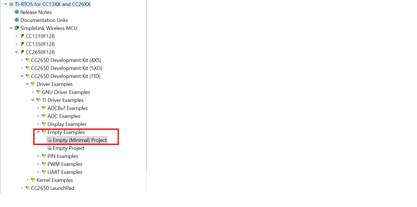

  • Can you provide a bit more information regarding which TI-RTOS version you are using? Which IDE you are using(CCS or IAR)? Are you running with BLE stack?  Which HW are you using to develop CC2640(Launchpad or sensortag?)
    The easiest way to do is using a TI-RTOS empty example project, then find the corresponding board file. In the main.c, you can comment out all the tasks. Then your program will look like this:

  • I guess "BM10_AN module with the CC2540. " is just typo. It looks like it's using our 7x7 package, so I will recommend you to do the following steps:
    1. import the project
    2. Modify the Pin accordingly, since we don't have your HW, you will have to make sure all the IO connection to external component is configured properly.
    3. Modify the main.c according to the previous comment.
    4. Program the device.

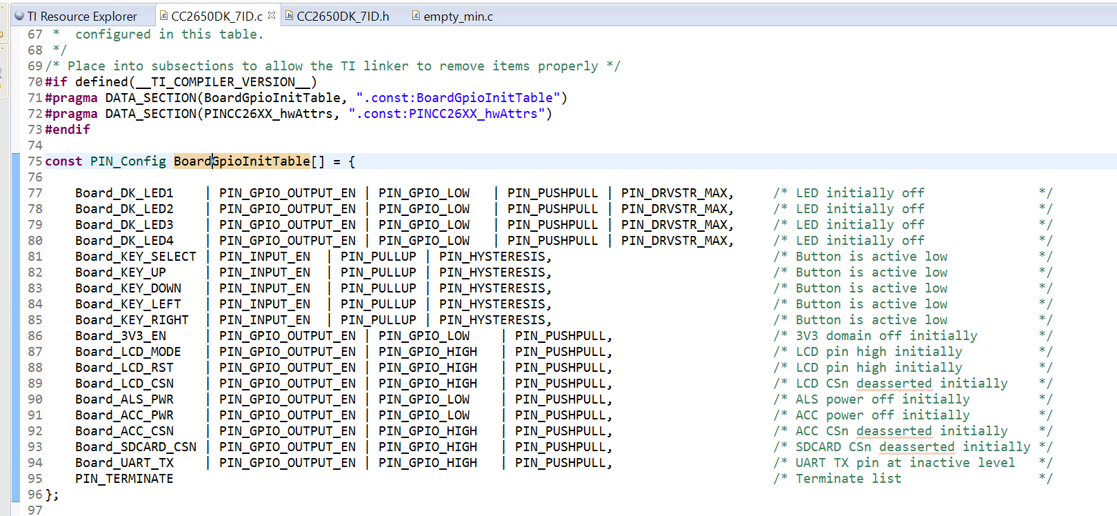

  • Can you see if you can execute from main.c and step through board init to just verify that the flashing process is successful?
    Also did you change all the pins to be no pull?
    Can you also take a picture of how you measure the current?
    Have you checked out the application note I attached?
  • I've set a breakpoint in main.c and could step through. So I think flashing is OK.
    Further, I've just changed all pins to Pull-up. With all pins set NOPULL, the board consumes 5.3mA.
    With all pins set to PULLDOWN, the board consumes ~1.6mA.

  • Did you disconnect from the JTAG domain when you are performing the current measurement?
    In your custom board file, can you check if the power saving is on, which is declared in xxxxboard.c file.
