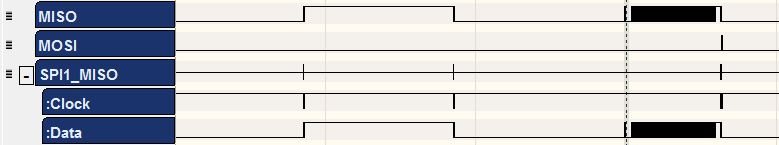

Error Scenario:
1. Aborting  of the connection is provoked.
2. Undefined behaviour on the SPI-MISO-Line (MISO toggles without SCLK signal)
3. BLE-Master sends on SPI "Connection Lost"
4. R-µC confirms "Connection Lost" with "Ack"
5. Furthermore undefined behaviour on the MISO-Line
6. R-µC sends on SPI "Reconnect" command
7. BLE-Master sends no answer on SPI
8. During the following seconds  BLE-Master sends only cyclic "Scan-Active" on SPI

    I`ve also attached the full logic trace of a failure scenario.
    At pos. "1" the BLEmaster (SPIslave) sends a Connection lost message.
    Ar pos. "2" the SPImaster sends the reconnect-request to the SPIslave (BLEmaster).

    Thank you for sending those notes and the full logic trace. I want to make sure that I am understanding the logic capture correctly:
    At pos 2. the SPImaster (SPI2_MOSI) sends the reconnect request successfully. Then, shortly after, the BLEmaster(SPI1_MISO) starts toggling without a clock. However, even after this happens, there are periods of time where both sides do seem to be sending data properly. Are you sure there is nothing but the SPI communication happening on these pins?
    You mentioned that you are using BLE Stack v1.4.0 on both CC2541 devices but what firmware are you running on them? Did you start with an example project?

  •  Hi Rachel,
    we think we have found the cause for our Problem that the "Reconnect" message ist not processed by the CC2541.
    I`ve attached a screenshot on which the SPI behaviour during "RECONNECTION" is shown.
    I call the upper Picture as pic1 and the lower Picture as pic2.
    In pic1 you can see the behaviour when 1 BLE-slave is linked.
    In pic2 you can see the behaviour when 3 BLE-slaves are linked.
    The Debug-Signal P1_0 is a DigOutputPin of the CC2541. The pin toggles in different sequences depending on which sofware parts are called.
    Description of pic1:
    Mark1: SPI-Slave (CC2541) sends "Connection Lost"-message
    Mark2: SPI-Master sends Ack-message
    Mark3: SPI-Master sends "Reconnect"-message
    Mark4: Decryption of Pin1_0 shows that the Software processed the Ack-message
    Problems of pic1:
    1. The Ack-message is only processed after the "Reconnect"-message has been sent.
    2. The "Reconnect"-message is not processed by the software
    Reaction of the CC2541 Software:
    1. CC2541 sends no "BLE-Reconnect" message.
     2. Reconnect Fails.
    Description of pic2:
    Mark3: Decryption of Pin1_0 shows that the Software processed the Ack-message
    Mark4: SPI-Master sends "Reconnect"-message
    Mark5: Decryption of Pin1_0 shows that the Software processed the Reconnect-message
    1. CC2541 sends  "BLE-Reconnect" message.
     2. Reconnection is successfully finished.
    Question:
    Why does the CC2541 SPI Software behave differently depending on how many BLE-slaves are linked?
    Actual Workaround:
    we've implemented in the SPI-master a delay-time after the Ack-message was sent.
