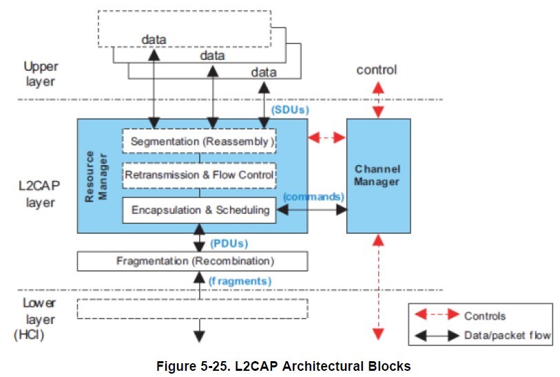

  • Hi JXS,
    thank You very much. If I understand You correctly, then with the current stack implementation I am not allowed to define attributes with sizes above 251 Bytes.
    You mentioned link layer for fragmentation. Is it really Link Layer or L2CAP layer responsible for fragmentation?
    You also mentioned that Link Layer will fragment when MAX_PDU_SIZE is 28-251
    >> If using the "LE Data Packet Length Extension" of v4.2 then my understanding is that You should be able to have packets of max 251 Bytes of length on radio level or is my understanding wrong and it is always 27Bytes on radio level?
    In the following image fragmentation seems to happen on the L2CAP layer
    While in Section 5.5.2 it says:
    The Bluetooth low energy stack supports fragmentation and recombination of L2CAP PDUs at the link layer.
    If I understand correctly than fragmentation/recombination can happen on Link Layer, but eventually it is the responsibility of the L2CAP layer to check and make sure PDU sequence/size is correct. Could You please clarify?
