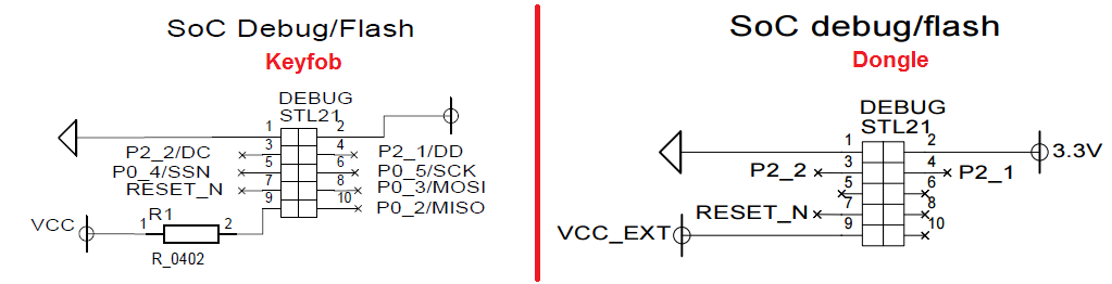

I need to know what is the correct layout of pins for then debugging CC2540.
Francisco
Those SPI pin connections are for SmartRF Packet Sniffer. You can refer to section 6.2.3 Minimum Connection for SmartRF Packet Sniffer in CC Debugger user guide.
