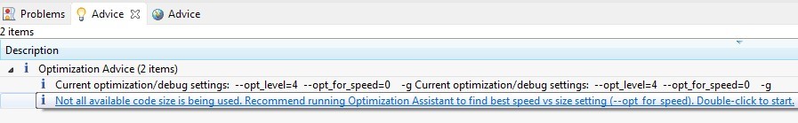

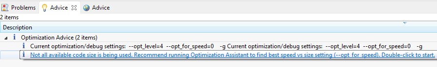

Last week I was able to run SBP examble in CC1350LP and get advertising data with no issue from it but suddenly I cant run anymore after build the project.
I noticed I am getting the follow message:
Any advise? I already made a clean reinstall for CCS 6.2, BLE STACK 2.02.01 which include TI-RTOS.

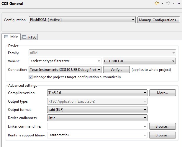

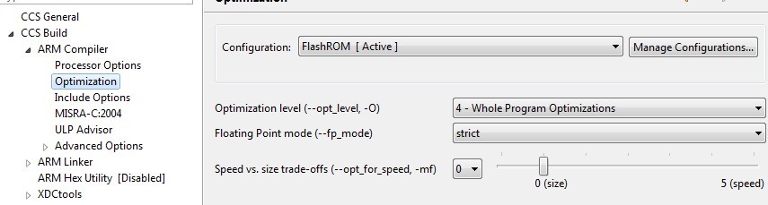

My current setting are:
and:
Thanks in advance

    These are the version I currently have installed in my system:

    Suddenly works now.
    I think it was an issue with the compiler now I'm using 5.2.8 and all working properly
