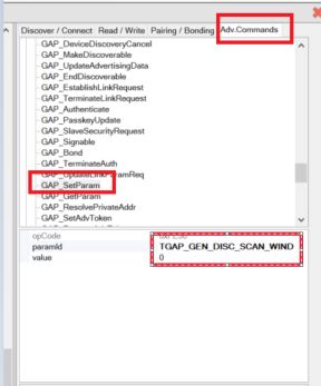

Hi all,
i'm using btool with CC2540 usb dongle; Default scan window is about 10 s. Is there a command to change (to reduce actually) this value?
Vito
  • Yes, you can change the parameter to whatever you want by
    1. Going into Adv.Commands
    2. Selecting GAP --> GAP_SetParam
    3. in the dropdown list, pick TGAP_GEN_DISC_SCAN_WIND to change your scan window. Make sure your scan window is not longer than your scan interval. Also the number is not ms. It's n * 0.625 mSec
  • Hi Christin,
    Thanks for your so useful reply!
    I was probably wrong in my initial post, I meant not the scan window, but the time interval between the GAP_DEVICEDISCOVERYREQUEST and GAP_DEVICEDISCOVERYDONE: in btool it is by default, i guess, 10 seconds. I don't know if this time is linked to scan interval and window... please can you clarify?
    Vito
  • You can also stop the discovery by sending GAP_DeviceDiscoveryCancel at anytime during the discovery.
