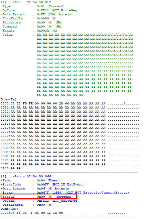

What is the Max PDU for BLE Stack Function HCI_SendControllerToHostEvent
Other Parts Discussed in Thread: CC2650, CC2640, CC2541
I'm using CC2650 Host_Test project in the Network Processor Mode by using UART to communicate with HCITester on the computer.
In order to test the max PDU for BLE Stack function "HCI_SendControllerToHostEvent", I've created a new function HCI_EXT_UTIL_TEST_FUNCTION (opcode: 0xFE87) encapsulated under "processExtMsgUTIL" to be called by HCITester.
Here is my code (red part) in ble_dispatch.c:

Then, I've called the correspondant function opCode 0xFE87 in HCITester:
Send_UTIL_TestFunction 0xEC
Wait_HCI_Vendor_Specific_Event ,
Send_UTIL_TestFunction 0xED
Send_UTIL_TestFunction 0xEE
Send_UTIL_TestFunction 0xEF
Send_UTIL_TestFunction 0xF0
Send_UTIL_TestFunction 0xF1
Normally, we can receive two events from CC2650, the 1st one is 0x0780(sent by my code) and the 2nd one is 0x067f (sent by "processExtMsg" function).
However, I can't get the 1st event 0x0780 when the PDU>=238 bytes and I can't get both of the events when PDU>=239 bytes, here is my HCITester Log:

  • Hi Yang,
    I am unsure about what you are trying to test. The TI BLE Software Developer's Guide covers how to setup your device in order to enable a larger PDU in Section 5.5.2.1 Configuring for Larger MTU values. Did you follow the steps given in the guide?
    If you read the L2CAP section in the User's Guide you will see that MAX_PDU_SIZE can be up to 255 bytes. That is the maximum amount of data that can be sent between the Host and the Controller. That is different than the maximum amount of User Data you can sent from the Application to the Controller. The difference is due to overhead created by L2CAP and GATT headers. L2CAP headers are 4 bytes. GATT headers depend on what command you are sending. You can see the Bluetooth Core Spec v4.2 for information about header sizes for various requests.
    I was able to write a 248 byte value over the air by doing the following:
    1. Using Host Test -> define MAX_PDU_SIZE=255
    2. Using Project Zero -> define MAX_PDU_SIZE=255
    3. In Project Zero data_service.h, changed DS_STRING_LEN to 248
    4. Using BTool, connect to the device running Project Zero
    5. Perform a GATT_Exchange MTU with a clientRxMTU parameter of 255. This gets negotiated to 251 because the L2CAP header is subtracted.
    6.  Perform a GATT discovery to find the handle of the String characteristic we modified in step 3. (should be listed as String Char)
    7. Write a 248 byte value to the String Char.
    8. You should see something similar to the below image. There should be 2 events that return success: GAP_HCI_ExtentionCommandStatus and ATT_WriteRsp
