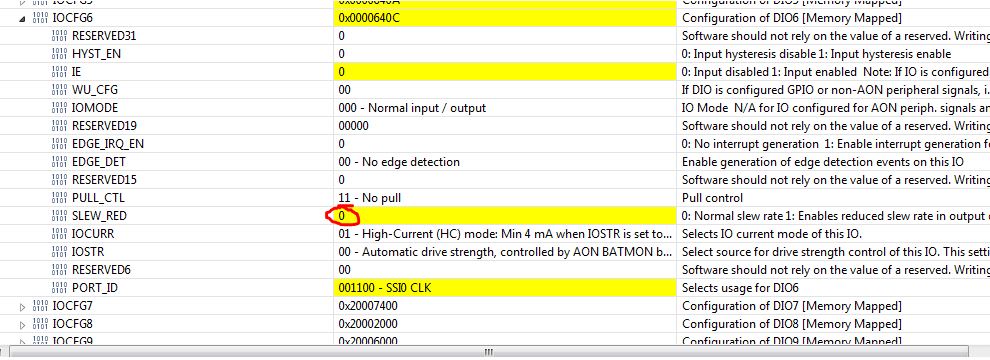

How to I change slew rate and drive strength settings for SPI? I’m getting poor signal integrity on my SPI output signals (SPI Clk and MOSI). I can improve the signal integrity by enabling the slow slew-rate (SLEW_RED) option in this register:
However, it looks like the slew rate & drive strength settings are hard-coded in the SPI_open() TI-RTOS function, and I don’t see a supported way to change this.
    Sort of. BLE example projects tend to include the SPI driver as source instead of linking in with the existing TI-RTOS libraries (for code footprint reasons). I suppose in your case, you'd probably want to modify it. You can add PIN_SLEWCTRL for CLK and MOSI in SPICC26XXDMA_initIO().
