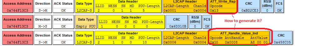

I am using simple_peripheral project in cc1350LP and I want to send Indication "I think so" where the peripheral send "commands" over BLE to a central device:
in similar way to:
https://e2e.ti.com/support/wireless_connectivity/bluetooth_low_energy/f/538/t/517467
I have more question... how is possible generate the output on RED? no the same data obviously because that is an example from the above link.
Do a custom profile generate it automatically?

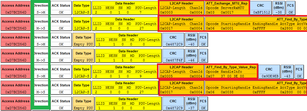

The direction on Green what's that supposed to mean? Master(central)-Slave(peripheral)?, Master-Server?, Client-server?

  • Hi Ale,
    Can you clarify what you mean by "generating the output in red"? Are you talking about the packet sniffer parsing the BLE data or do you mean generating the packet structure?
    The custom profile will not send the information automatically but it does create the attribute data. Since you've already reviewed the TI BLE Software Developer's Guide and SimpleLink Academy, you can learn more about attribute data and structure in the BLE Core Spec v4.2.
    Direction refers to which direction the information is being send (Master->Slave)

  • Hi Rachel, Thanks a lot for answering.
    Yes, I want to generate the packet structure and send my own data. I am able to get data from the ADC and I want to sent It to another BLE(central) using a similar structure once the connection is established and not just in advertising mode.
    If the custom profile wont send the information automatically do I have to make a custom task? Or just modifying the currents in the simple_peripheral will work? I want to learn more about BLE but how can I apply the BLE Core Spec 4.2 in code for CCS?

  • I found the characteristics values now I am planning to use Characteristic 4 because are notify(could it be change to indications?)
    Now I want to send for example:
    a specific Opcode
    a specific AttHandle
    a specific AttValue
    How can I change it? to sent my own
    I cant find the variables to set it
    Is it related to SimpleProfile_SetParameter() and GATTServApp_ProcessCharCfg()? how can it be applied to my case?
