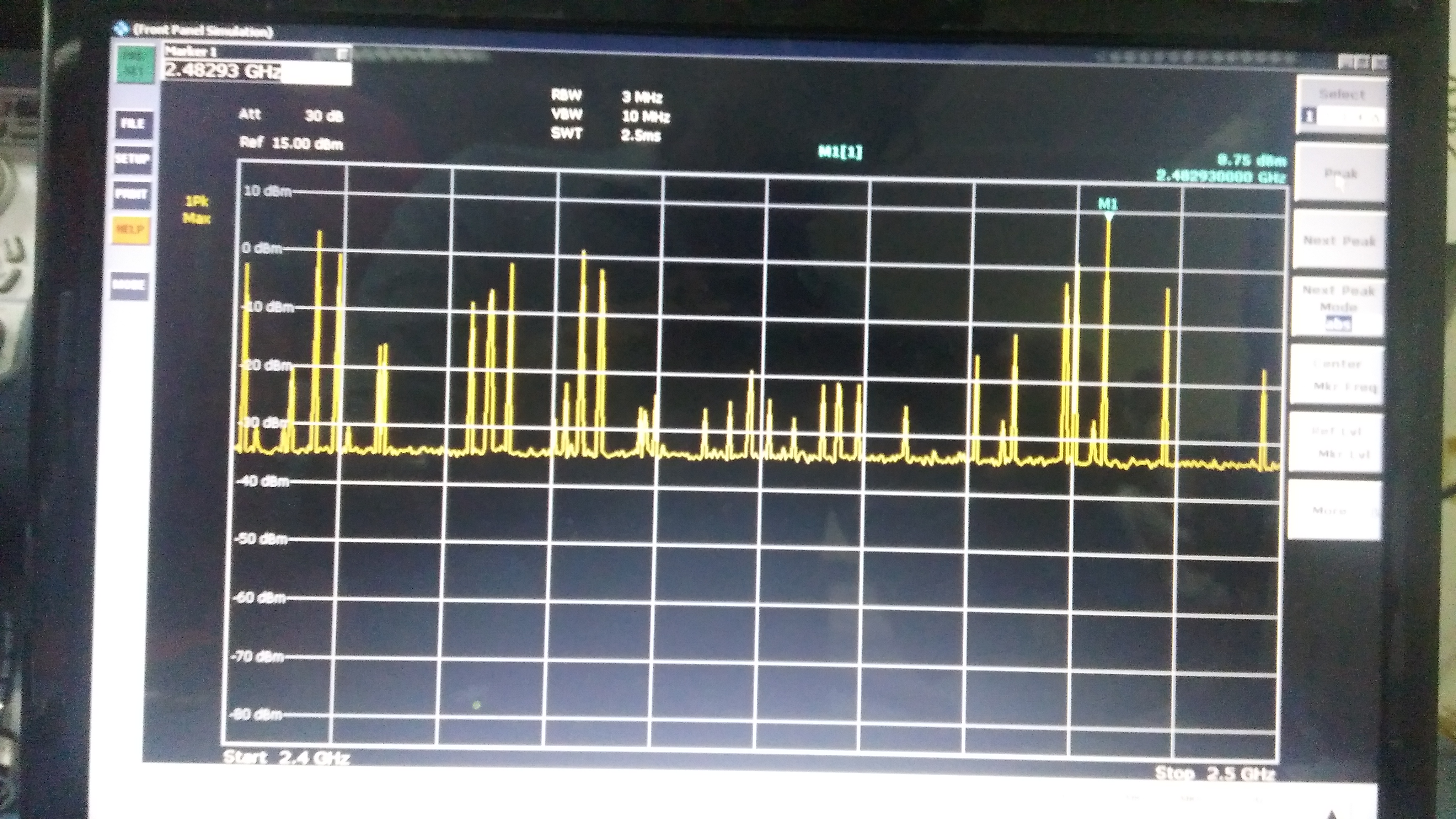

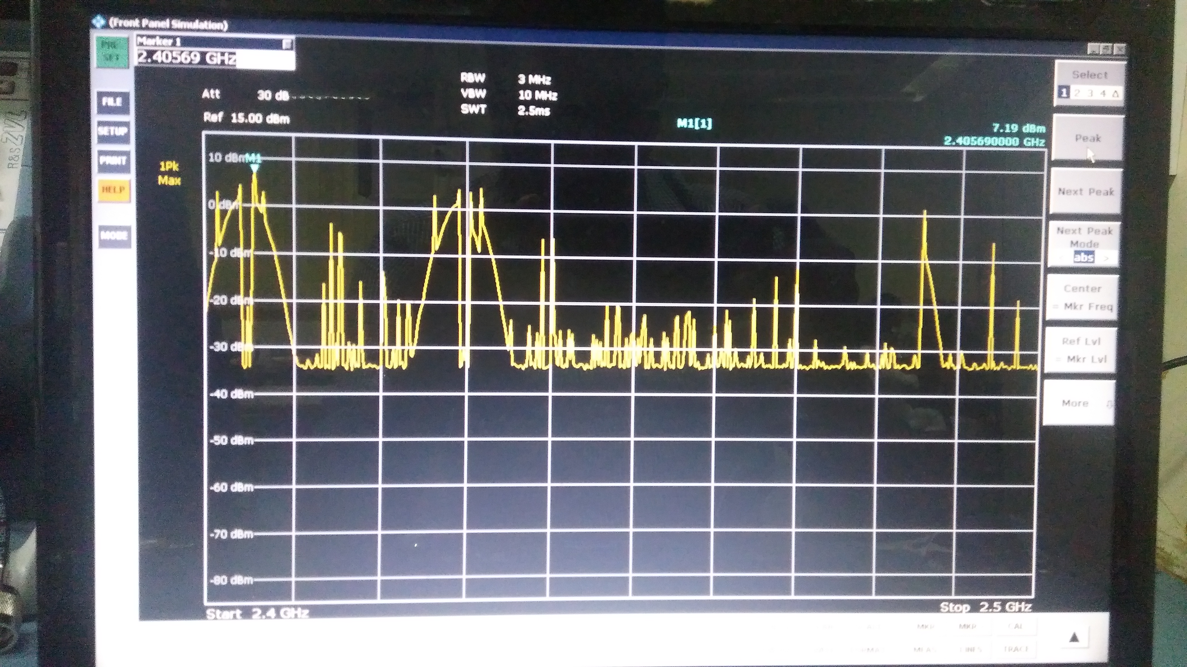

I am using CC2564MODN for one of my projects.Few of my modules are not working(Not working in the sense, i am unable to communicate). Not working modules are outputing power similar to working modules. On a spectrum analyser, i found the spectrum of these two as different. Attached below are the spectrum images of both.
1. Working Module Spectrum
2. Non Working module spectrum
What might be the reasons for this?

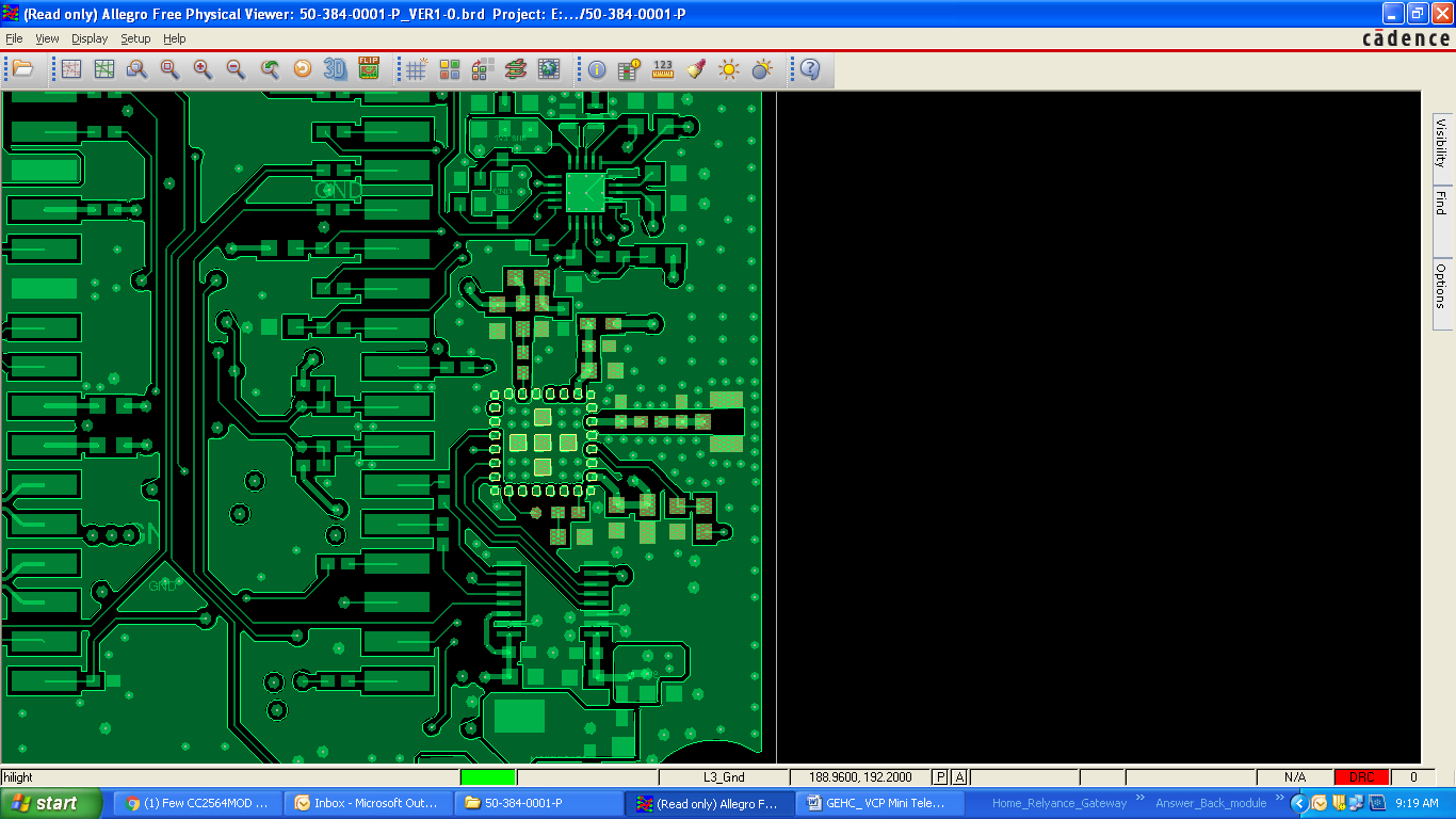

  • Hi Mitchell Kinkeade
    Thanks for the support.
    Please find attched the screen shot of layout with CC2654MODN and associated circuitry highlighted.
    Riyaz
  • Hi Riyaz,
    From what I can see in the above image, the layout looks okay. Is there any way you can share a schematic capture of the RF path on the CC2654MODN? I'm curious as to what components and chip antenna you are using. Also, is the trace width on that path matched to 50ohm?

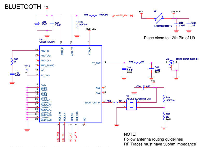

  • Hi Mitchell
    Attached is the schematic view
    Out of 30 prototypes, 15 failed.
    Trace width match to 50Ohm impedance performed.
    We are using a flex PCB antenna not a chip antenna.
    Please go through the schematic and share your views.

  • Hi Riyaz,
    Thank you for sharing. I think the issue might be coming from the RF path, as there is no LC filter prior to the antenna connector. Adding in a matching filter could help eliminate the noise you are seeing on the spectrum analyzer.
    The reference schematic found inside the CC2564 datasheet (page 29) uses a chip antenna and has a LC filter in place to balance the antenna.
    You might be able to replace R48 with an 9.1uH inductor, or similar, and see if that provides any improvements.
    Right now, this is my initial assessment; however, I'm going to loop in some experts to offer up their suggestions as well.
