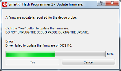

Formy CC2650 LaunchPad, I am trying to use the SmartRF Flash Program version 2-1.7.5 (dated 09-Dec-2016) on Windows 7 to load new firmware program, but  the SmartRF Flash wants to update the Debug Probe before I upload any new program.  When I do that the program fails for a firmware update for the Debug Probe -- same result with SmartRF Flash Program version 2-1.7.4.

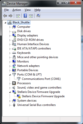

I tried to update the Debug Port via the command line with 'xdsdfu -m' which placed the board in DFU mode, and then 'xdsdfu -f firmware.bin -r' from C:\TI\ccs_base\common\uscif\xds110, but the Stellaris Device Firmware Upgrade driver is not there.
I tried manually installing the driver from Stellaris® ICDI Drivers_spmc016a_21-Jan-2016, but that did not work either.
What am I doing wrong?
