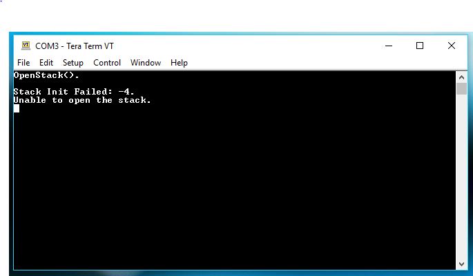

I have been trying to run the SPP demo for CC2564 and MSP430F5438A.
I have followed the steps mentioned in
processors.wiki.ti.com/.../CC256x_MSP430_TI_Bluetooth_Stack
and
processors.wiki.ti.com/.../CC256x_TI_Bluetooth_Stack_SPPDemo_App
After debug, when I run the code, I am getting Stack Init Failed: -4 over the UART in the terminal.

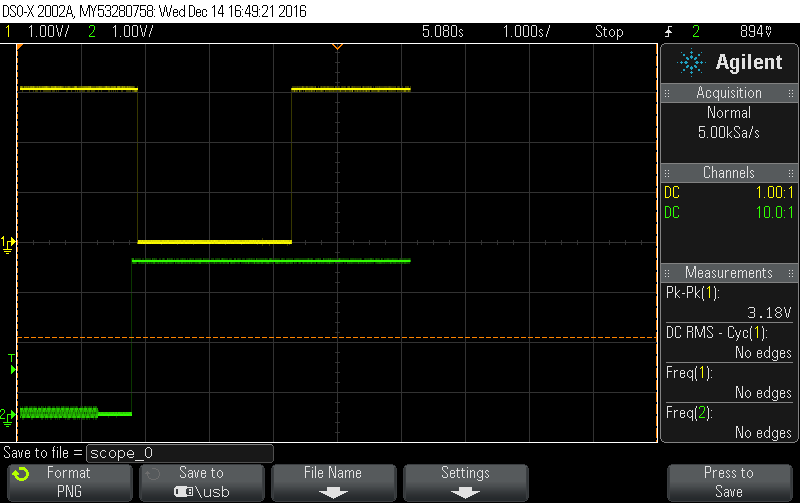

I verified the slow clock and the frequency is 32,768 Hz. I cannot check the fast clock since the eval board has CC2564MODN for which the fast clock is internal.
After Debug, when I run the code, the UART_RTS gets pulled low after nSHTD is pulled high (below is screenshot from scope, channel 1 is UART_RTS and channel 2 is nSHTD).
UART_RTS remains low for a few seconds after which it goes back to high and the following error message is displayed on Teraterm.
I am directly dumping the given sample code that comes with the bluetopia stack as mentioned in the tutorial without any modification whatsoever.
I have been stuck in this state for over a month and I am totally clueless how to move forward.
I read many discussions on the forum with the same error code but those fixes don't seem to work for me. Please help. Any suggestions would be of great help.
