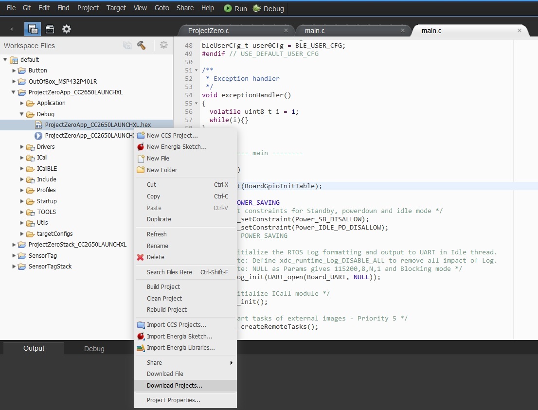

    I don't really need the hex file of the project zero. I have a project of my own.
  • Do you use CCS? or IAR?
  • I am using CCS Cloud.
  • Checking with CCS cloud, I can see hex file is output on debug folder and you can download it.
  • I loaded the hex file (Project Zero for now) onto the MCU but I don't see the device in the BLE Scanner.

    Does the resetting at the end has something to do with the launchpad not transmitting?
  • Do you also download ProjectZeroStack to your LAUNCHXL-CC2650?
