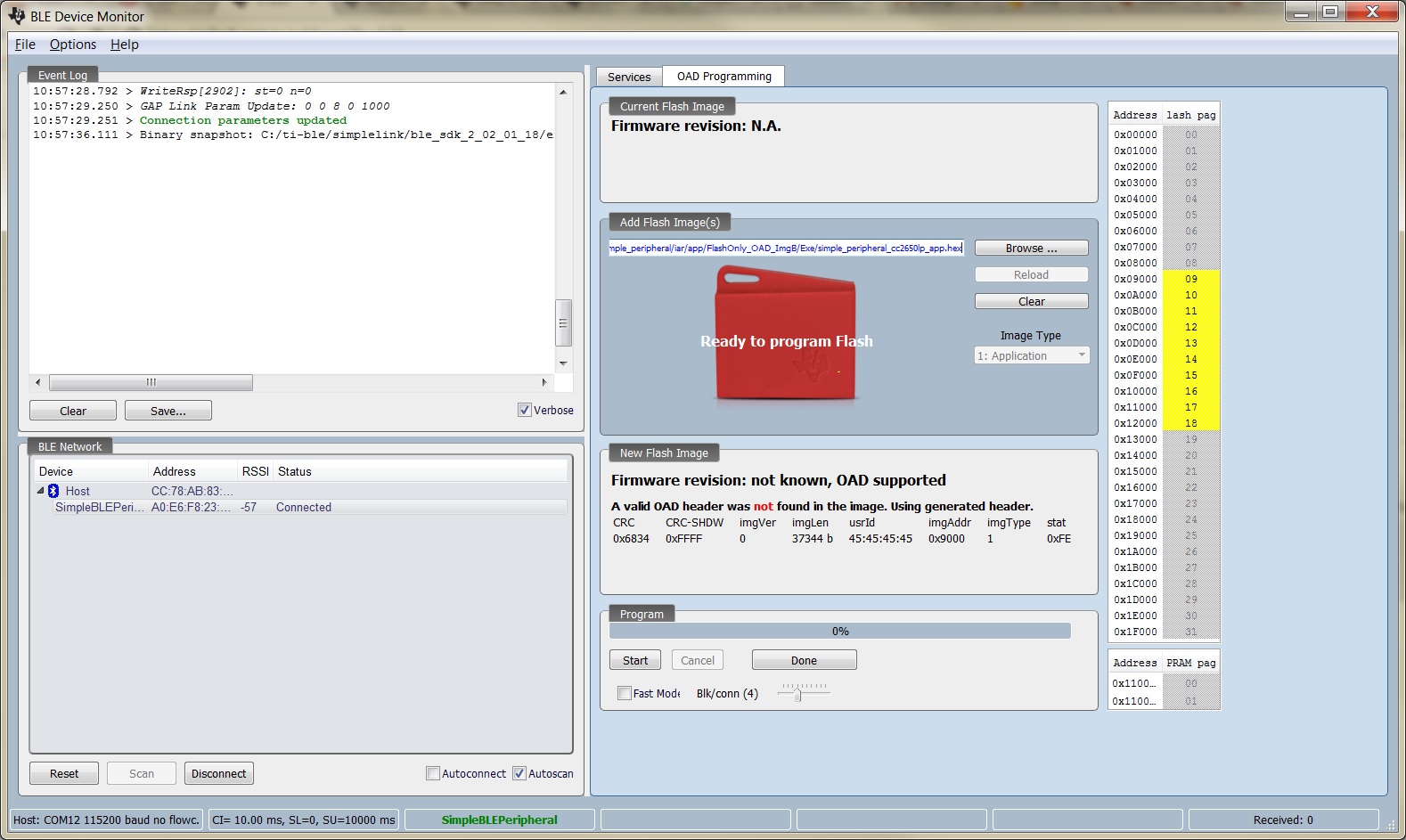

CC2640: A valid OAD header was not found in the image
Part Number: CC2640
Other Parts Discussed in Thread: , CC2540, CC2650
I'm trying to implement On-Chip OAD using CC2640. I followed cc2640 BLE OAD User's Guide and when I added SimpleBLEPeripheral image to BLE Device Monitor I got a message "A valid OAD header was no found in the image. Using generated header".
Why would I get this when I  made no changes to the project?

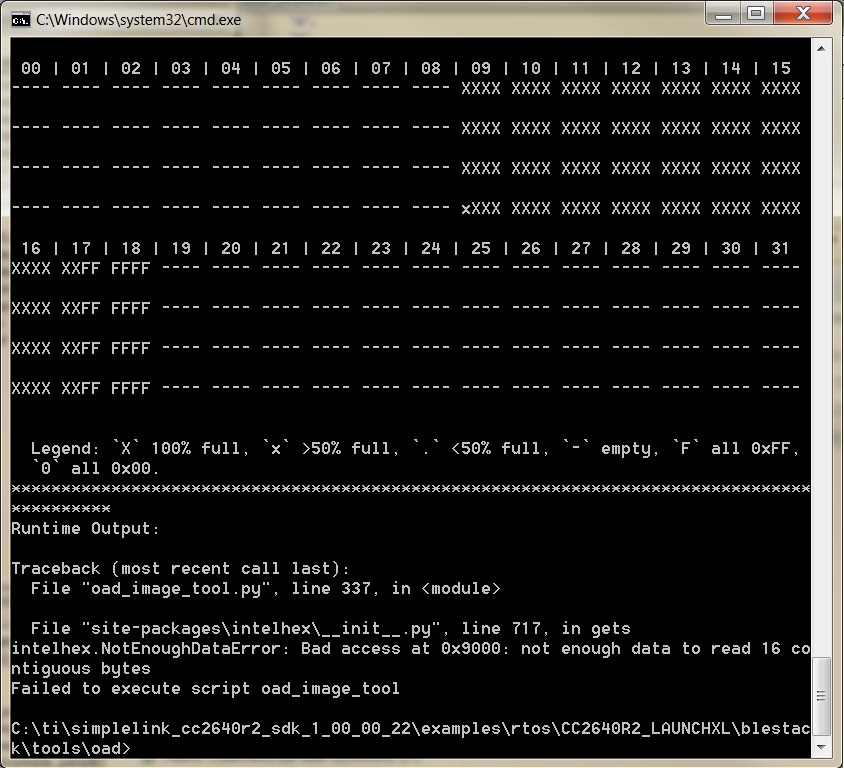

  • It looks like that's for another part, I am using cc2640 and those instruction are for cc2640r2f. I'll look to see if it will work for mine.
    Thanks!

  • Hi Rebel,
    it looks like when i use BLE monitor and load .bin file the OAD header is fine, but when I load .hex file the OAD header was not found. Why would that be?

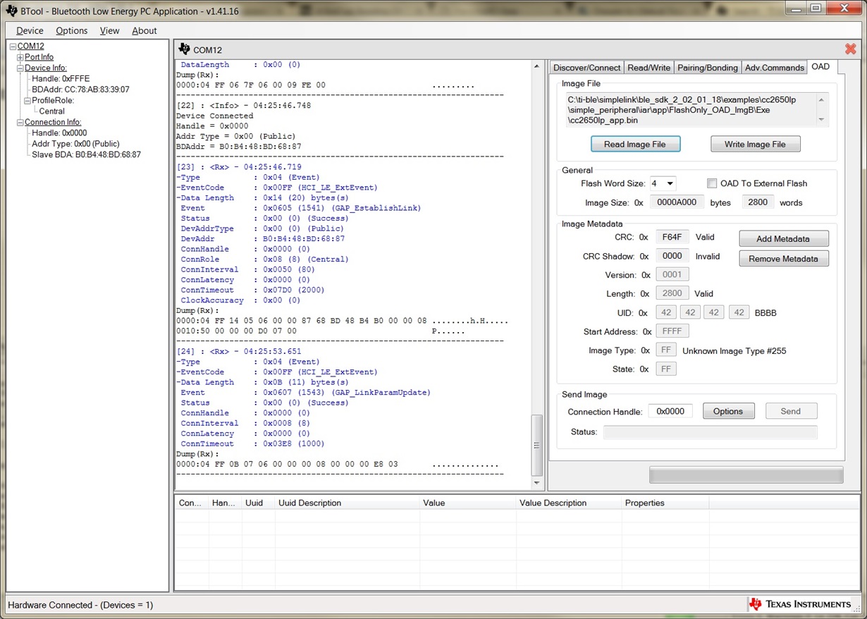

  • Hi Mario,
    Actually, I highly recommend using BTool for OAD instead. Although slower right now, it's much more robust.
    I'd download the CC2640R2F SDK and use the included btool on there. ( see processors.wiki.ti.com/.../CC2640_OAD_User's_Guide )
    It only takes BINs, so none of that hex file annoyances.
    Rebel
  • Hi Rebel,
    I switched to using BTool now and followed instructions and when I went to OAD tab and loaded an image the image metadata had invalid fields. Why do you think that is? I am using IAR btw.

  • Yes I can attach the files. I just have to figure out how to do it. I tried attaching and it didn't let me attach a bin file. so I changed the extension to .txt.
    The default example didn't work, that's where I'm seeing a problem with BIN file image metadata.

  • Hi Mario, looking at the first 16 bytes shows:
    4ff6 0000 0100 0028 4242 4242 ffff ffff
    Basically, for what ever reason incorrectly placing the metadata, app start address, along with the image type. (FF for state is fine)
    Eg. building the onchip img_b on my computer results in:
    5768 ffff 0100 001e 4242 4242 001c 01ff
    My best guess is that your post build step with oad_image_tool (or you just forgot to add the flags) is incorrect.
    You can modify the header in BTool as well, click the remove metadata button and click add metadata then fill in the data you want. (A warning will come up saying there is existing meta data. Overwrite it.) Then click on Write image file to output a new bin.
    Anyway take care to point to the right spot for program start: heres the command in the SDK, what's yours?
    "$TOOLS_BLE$\oad\oad_image_tool.exe" "$PROJ_DIR$\FlashOnly_OAD_ImgB\Exe\simple_peripheral_cc2640r2lp_app.hex" -t onchip -i app --imgVer 0 --usrId BBBB -ob "$PROJ_DIR$\FlashOnly_OAD_ImgB\Exe\simple_peripheral_cc2640r2lp_app_oad.bin" -m 0x7000 --r 0x7000
    I highly recommend getting the example to work first, reinstall the SDK if you need to. The out of the box onchip oad example should work.
    Rebel

    So I used the following from a command line interface:
    \ oad_image_tool simple_peripheral_cc2650lp_app.hex -ob app_oad.bin -t onchip -m 0x9000 -r :0x12000
    And I got an error "not enough data to read 16 contiguous bytes". What does that mean?
    I'm attaching a screenshot.

    That sounds like the issue you're seeing - are those two bytes generated by your code or by IAR?
    One of the core requirements of OAD is leaving 16 bytes of space for the metadata vector. You'll need to adjust the linker file to allow for this space.
    If IAR is generating the CRC, then you should remove this from the hex generation. You'll see options on checksum under IAR Linker catagory, disable these.
    Rebel

    Apparently OAD image creation was successful. So I started BTool and went to download the image and it failed.
    Here's what the image header in BTool looks like:
    Why doesn't this update work now?
    I'm also attaching the .BIN file created by OAD IMAGE TOOL. *I changed the extension to .txt so I can upload it.

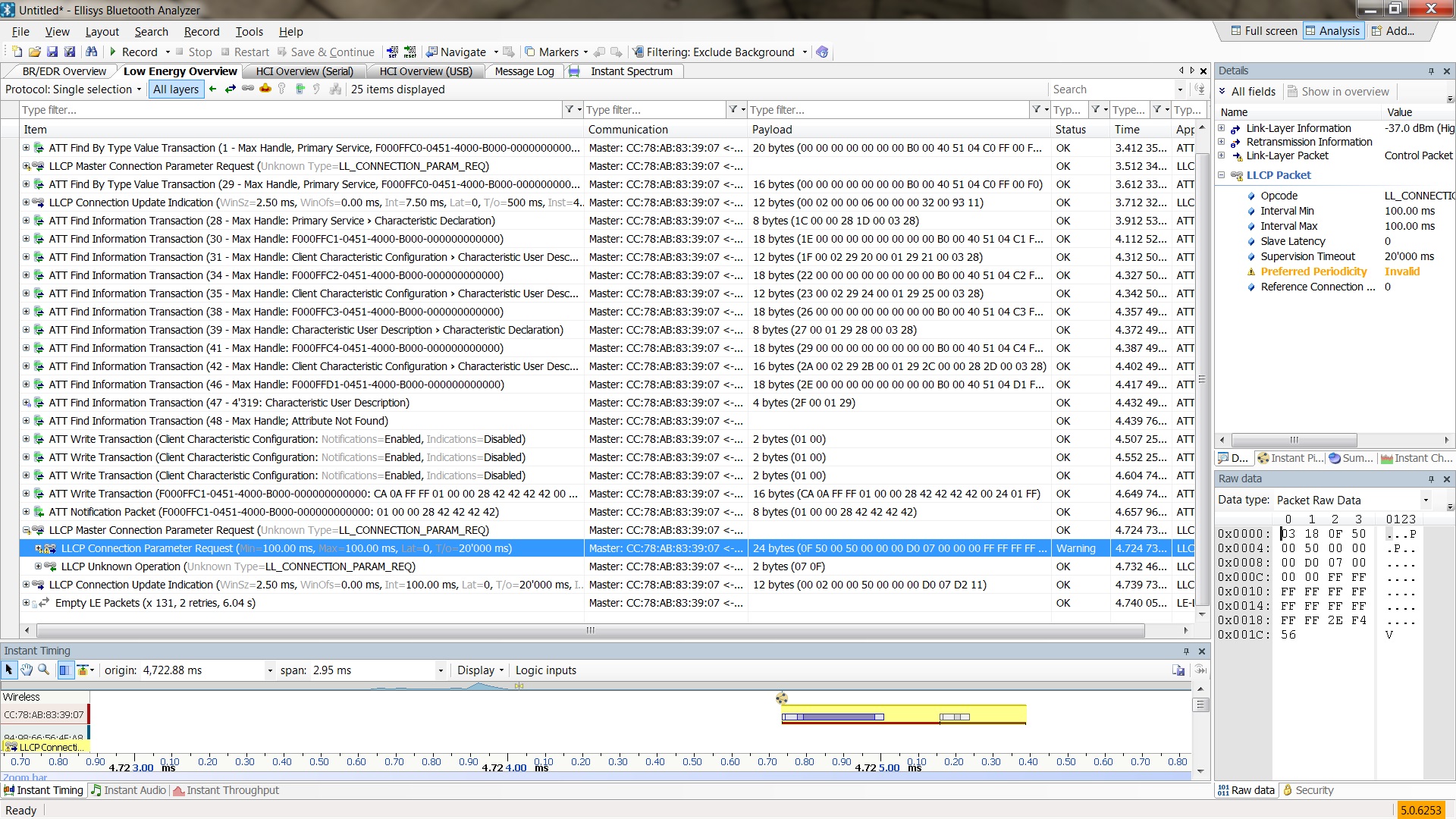

  • Hi Rebel,
    I got the sniffer. I'll attach a screenshot of BLE packets. It looks like the first 16 bytes were transferred only. I don't know what "master connection parameter request" was for. I'm assuming the something went wrong for master to ask for that.
    What are your thoughts?
    Mario
  • Hi Mario,
    Actually, the whole connection parameter request thing/update thing is fine. That's probably because your device didn't support the feature.
    More importantly, looks like your image was rejected - take a look at http://software-dl.ti.com/lprf/simplelink_cc2640r2_sdk/1.00.00.22/exports/docs/blestack/html/oad/oad.html#oad-image-identify-0xffc1

  • Hi Rebel,
    yes the image is rejected. I had debugger running on my A image while I was trying to do an OAD update. It looks  like it fails the image header version test.
    (OAD_IMG_ID(ImgHdr->ver) != OAD_IMG_ID(rxHdr.ver)
    Let me start first by asking what I should enter as "imgVer" when I run oad_image_tool ?
    What is the different between --imgVer 0 and --imgVer 1?
    oad_image_tool simple_peripheral_cc2650lp_app.hex -t onchip -i app --imgVer 0 --usrId BBBB -ob app_oad.bin -t onchip -m 0x9000 -r :0x13000
  • Another thing I forgot to mention is that during "image identify" process I noticed the contents of the current Image header are all '0xFF'.
    Is this normal?
    So when I get to this line of code : (OAD_IMG_ID(ImgHdr->ver) != OAD_IMG_ID(rxHdr.ver))   I am seeing:
    ImgHdr->ver = 0xFFFF.
    So for me to pass that point I'd need to have my metadata imgVer be a number that doesn't have LSB=1, or else the image will get rejected.
    Mario
  • Here's some more info....
    when I want to create metadata vector with different image versions it seems like I can't generate every version I want. Every image version has to end with LSB=1 and the oad image tool automaticall converts it to a number that has LSB=1.
    For example lets say I want imgVer = 2 ( LSB in this instance would be 0).
    The command is below:
    oad_image_tool simple_peripheral_cc2650lp_app.hex -t onchip -i app --imgVer 2 --usrId BBBB -ob app_oad.bin -t onchip -m 0x9000 -r :0x13000
    After I run it the oad image tool automatically converts imgVer to 3.
    The image version check code
    always results in FALSE since OAD_IMG_ID(ImgHdr->ver) is always 0x01 due to the fact that ImgHdr->ver = 0xff by default (my previous post mentions this).
    So that's why my image gets rejected all the time.
    So I have 2 questions:
    1. Why does tool change LSB for image versions?
    2. Why is default (OAD target image) image header all 0xff ?
    Mario

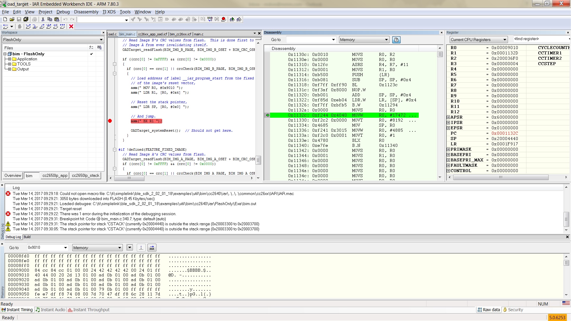

  • Hi Rebel,
    I looks like Image A is not running either, after it goes through BIM. When I step through the code the address is jumps to is in the middle of instruction.
    Here's the code for jumping into Image A:
    // Load address of label __iar_program_start from the fixed location
    // of the image's reset vector,
    asm(" MOV R0, #0x0610 ");
    asm(" LDR R1, [R0, #0x4] "); //loads R1 with 0x7D59
    // Reset the stack pointer,
    asm(" LDR SP, [R0, #0x0] ");
    // And jump.
    asm(" BX R1 "); // jump to 0x7D59
    -The address 0x0610 is the vector table address, and as you can see we load the address that's located at 4 byte offset and the value in that location is 0x7D59.
    First, that address is an odd number, which is weird, so we actually jump to 0x7D58.
    Second, it's in the middle of another instruction.
    Basically after jumping to this address processor gets lost.
    Is there a way to know how this address (0x7D59) was determined as the jump point? Or better yet where am I suppose to jump to to run Image A?
    And it looks like I have the same problem with Image B, because the code is identical.
    Mario

  • Hi Mario,
    Can you attach the sniffer capture?
    As noted in the http://software-dl.ti.com/lprf/simplelink_cc2640r2_sdk/1.30.00.25/exports/docs/blestack/ble_sw_dev_guide/html/oad/oad.html#oad-process
    If image_status isn't success - as Btool is reporting, AND it shows up on the sniffer, there's another issue here.
    How is it reading 0x9014? Can you paste the code here?
    The code should jump to the reset vector of your IMGB if it's valid
    Rebel

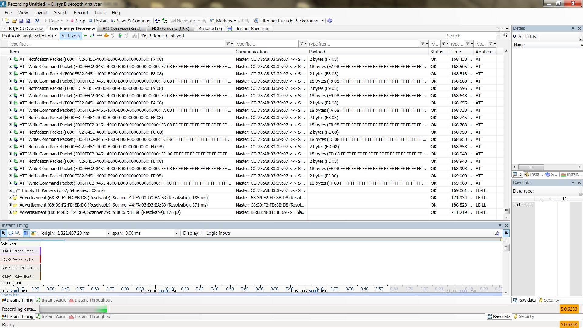

  • Hi Rebel,
    here's the sniffer capture. You see the last byte is being sent and nothing happens after that and the reason is because slave gets reset.
    Here's the part of the code that executes system reset:
    // Check if the OAD Image is complete.
    if (oadBlkNum == oadBlkTot)
      #if FEATURE_OAD_ONCHIP
    // Handle CRC verification in BIM.
    OADTarget_systemReset();
    #else // !FEATURE_OAD_ONCHIP
    So as soon as the last block is transferred BTOOL loses connection.

  • Hi Rebel,
    I looked at the technical ref manual and 0x9014 now makes sense. So now the question is why doesn't it run the image after it jumps to that address?
    Here's the debug screenshot after it jumps to the reset vector. The reset vector address is 0x1132D and it jumped to 0x1132C.
