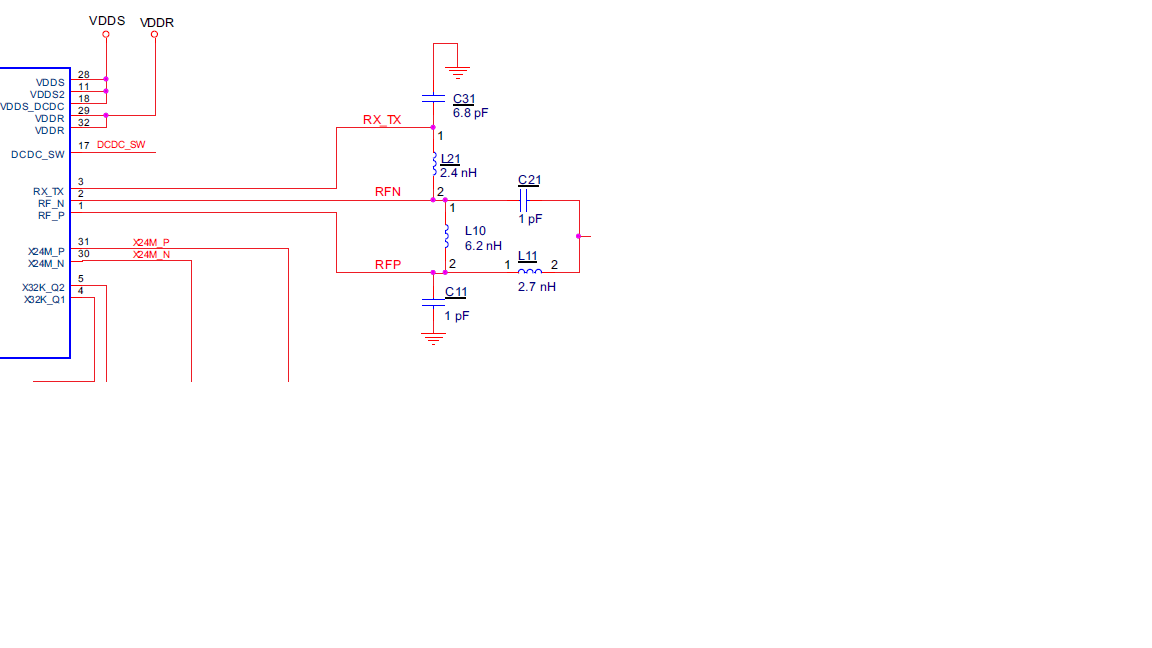

CC2650: Use of RX_TX pin
Part Number: CC2650
I don't see a detailed explanation on the RX_TX pin in the datasheet, other than the description: Optional bias pin for the RF LNA.
Is this a digital or analog I/O? How does it work in the reference circuit below, which doesn't appear to have an external LNA.
Appreciate any input from the forum.
