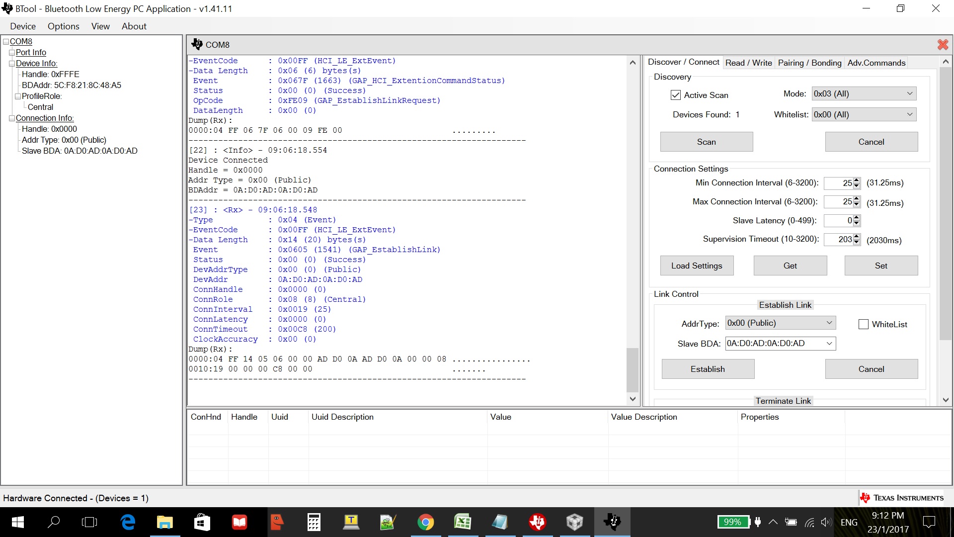

   I am following the CC2640R2 On-chip OAD procedures. There illustrates the use of BTool for OAD. But my BTool do not have OAD Tab. The version is v1.41.11. Is there another version of BTool that has OAD tab?
- kel
  • You can find the newest Btool here which contains the OAD tab:
    C:\ti\simplelink_cc2640r2_sdk_1_00_00_22\tools\blestack\btool
  • Thanks a lot, Christin. I was stuck at that part of the guide for a while. The on-chip BTool OAD works. So, that's great.
