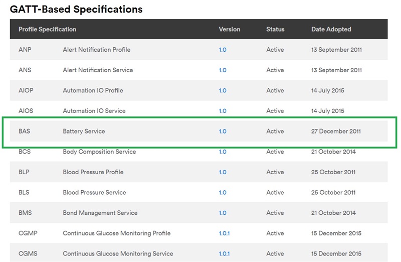

Hi Sir / Madam,
I am porting the following files from     tirtos_cc13xx_cc26xx_2_20_01_08 folder,
to simple_peripheral project inside simplelink_cc2640r2_sdk_1_00_00_22.
And, I need to check these files version against the version in Bluetooth SIG
( https://www.bluetooth.com/specifications/adopted-specifications ).
Inside the description of these file, I only get the Release Name and release date, but not the revision.
May I know where should I get the version of the following files ?

  • I am not sure about what those hex value mean I suppose they are like the commit number in github.
  • Hi Yikai,
        My colleague is checking revision to see if this service file below for example is latest revision and comply with what is in the https://www.bluetooth.com/specifications/adopted-specifications. We are porting this file from C:\ti\simplelink\ble_sdk_2_02_01_18\src\profiles\batt\cc26xx to CC2640R2 SDK profiles folder. This revision checking is to know if it is okay to use this file for CC2640R2 BLE Product Development.

  • Actually, I have no idea why Bluetooth 5 SDK ( simplelink_cc2640r2_sdk_1_00_00_22 ) does not have battery service but I think you can add it to your application by yourself.
    I think you are right. Also, at CC2640R2 SDK Docs "Porting Guide from cc2640 to cc2640r2" mention this below, hinting that you can add the files to CC2640R2 SDK profiles folder.
    2. Transfer all modified application files into the example project
    Place modified profile and application files the existing files in the Simplelink CC2640R2 SDK to match those in BLE-Stack 2.2.1 project.
    - kel
