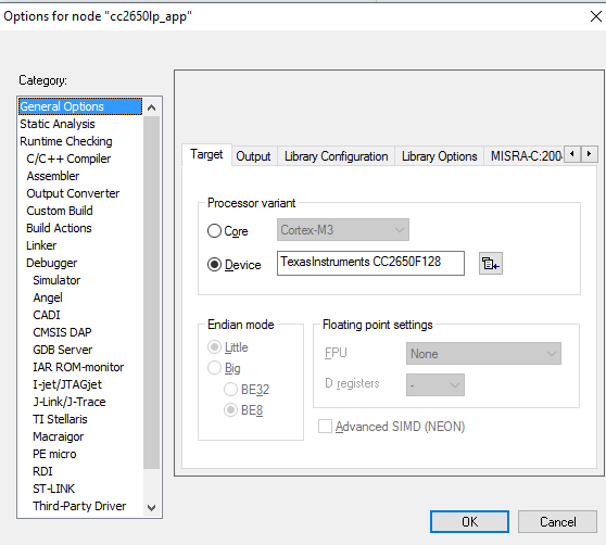

Hi Sir / Madam,
I am using IAR IDE and rearranging the file structure of CC2460R2.
One of the example file inside "blestack" folder : D:\ti\simplelink_cc2640r2_sdk_1_00_00_22\examples\rtos\CC2640R2_LAUNCHXL\blestack   ,
is taken out and place it into "ti" folder :  D:\ti  .
So when I compile it, it has error, such as :  Cannot find input file .....  .
May I know how can I modify the   " peripheral_example.custom_argvars" so that it can compile successfully ?
My file structure is :
D:\Project\Example_peripheral\Example_peripheral
D:\Project\Example_peripheral\simplelink_cc2640r2_sdk_1_00_00_22
D:\Project\Example_peripheral\xdctools_3_32_01_22_core
Thank you very much.
Your effort is very much appreciated.
Cheers,
KF

  • Hi Christin,
    Thanks for your reply. I have done that.
    However, when compile the stack, error message pop up (IAR 7.80):
    Could not launch the tool
    D:\Project\simple_peripheral.........
    System Error Code : 2
    System Error Message : The system cannot find the file specified.
    Any idea where to configure this ?
    Please advice.
    Cheers,
    KF

  • Hi Christin,
    Thanks for your reply. I have check and recheck my setting in the project option.
    I have found some path error and have corrected it.
    However, I still have error when Rebuilt All in IAR 7.80.
    (A). The following is the successful compilation, when project folder reside in the recommended location --> D:\ti\simplelink_cc2640r2_sdk_1_00_00_22\examples\rtos\CC2640R2_LAUNCHXL\blestack\Simple_Peripheral .
    (B). However, my project requirement need me to change to another folder, example located at -->
    D:\ti\Simple_Peripheral . Inside D:\ti\, I have simplelink_cc2640r2_sdk_1_00_00_22 and xdctools_3_32_01_22_core folders.

  • Since you are changing the whole structure of the file location, you also need to modify all the include path in IAR setting .ewp file. It's not recommended to just move the project folder to top level since there are lots of the included files are using location relative to the project location.
  • Hi Christin Lee,
    Many thanks for your explanation.
    I have finished configure the following :
    (1) Inside IAR IDE: Tools-->Configure Custom Argument Variables
    (2) Inside Options for node example_project_App:
    (1) c/c++ compiler --> Preprocessor --> Additional include directories
    (3) I have compile each individual .c file in the tree for App. All compile no error.
    Left is look into .ewp file of App. But it seems this file is following all the settings above.
    There is one configuration I have not done because I do not understand what does it means. It is inside Options dialogue box of App project --> category Build Actions --> Pre-build command line: "$XDCROOT$/xs" --xdcpath="$XDCPATH$" iar.tools.configuro -c "$TOOLKIT_DIR$" --cc "$COMPILER_PATH$" --device "$DEVICE$" --compileOptions $COMPILER_ARGS_ROOT_QUOTED$ --linkOptions $LINKER_ARGS_QUOTED$ --profile release --projFile "$PROJ_PATH$" --cfgArgs NO_ROM=0
    May I have your advice on the above. May I know what does it means and how should I modify it ?
    The failure compile result is :

  • Hi Christin,
    I have done almost all the settings.
    (1) Tools --> Comnfigure custom argument variables
    (2) Options for App --> category C/C++ compiler --> Preprocessor
    (3) compile each .c file in the app project tree, all pass individual compilation.
    Left this one I do not understand how to modify it :
    Inside Options for node "Example_App" --> category Build Actions --> Pre-build command line:
    Would you please advice me on this ? how to modify it ?

  • Hi Christin,
    (1) May I know how can I unlock the permission of the following  file in (1), in bold ?
    (2) May I know how and where can I change or modify the following path, in (2)  ?
    Building configuration: FOBO_Bridge_Stack - FlashROM
    Updating build tree...
    D:\Project\FOBOBridge\FOBOBridge_kfchoong\FOBO_Bridge\tirtos\iar\stack\FlashROM\Obj\common_rom_init.o
    D:\Project\FOBOBridge\FOBOBridge_kfchoong\FOBO_Bridge\tirtos\iar\stack\FlashROM\Obj\rom_init.o
    D:\Project\FOBOBridge\FOBOBridge_kfchoong\FOBO_Bridge\tirtos\iar\stack\FlashROM\Obj\hal_assert.pbi
    D:\Project\FOBOBridge\FOBOBridge_kfchoong\FOBO_Bridge\tirtos\iar\stack\FlashROM\Obj\hal_flash_wrapper.pbi
    D:\Project\FOBOBridge\FOBOBridge_kfchoong\FOBO_Bridge\tirtos\iar\stack\FlashROM\Obj\hal_trng_wrapper.pbi
    D:\Project\FOBOBridge\FOBOBridge_kfchoong\FOBO_Bridge\tirtos\iar\stack\FlashROM\Obj\gatt_uuid.pbi
    D:\Project\FOBOBridge\FOBOBridge_kfchoong\FOBO_Bridge\tirtos\iar\stack\FlashROM\Obj\ble_dispatch_JT.pbi
    D:\Project\FOBOBridge\FOBOBridge_kfchoong\FOBO_Bridge\tirtos\iar\stack\FlashROM\Obj\ble_dispatch_lite.pbi
    D:\Project\FOBOBridge\FOBOBridge_kfchoong\FOBO_Bridge\tirtos\iar\stack\FlashROM\Obj\icall_lite_translation.pbi
    D:\Project\FOBOBridge\FOBOBridge_kfchoong\FOBO_Bridge\tirtos\iar\stack\FlashROM\Obj\npi.pbi
    D:\Project\FOBOBridge\FOBOBridge_kfchoong\FOBO_Bridge\tirtos\iar\stack\FlashROM\Obj\osal.pbi
    D:\Project\FOBOBridge\FOBOBridge_kfchoong\FOBO_Bridge\tirtos\iar\stack\FlashROM\Obj\osal_bufmgr.pbi
    D:\Project\FOBOBridge\FOBOBridge_kfchoong\FOBO_Bridge\tirtos\iar\stack\FlashROM\Obj\osal_cbtimer.pbi
    D:\Project\FOBOBridge\FOBOBridge_kfchoong\FOBO_Bridge\tirtos\iar\stack\FlashROM\Obj\osal_clock.pbi
    D:\Project\FOBOBridge\FOBOBridge_kfchoong\FOBO_Bridge\tirtos\iar\stack\FlashROM\Obj\osal_memory_icall.pbi
    D:\Project\FOBOBridge\FOBOBridge_kfchoong\FOBO_Bridge\tirtos\iar\stack\FlashROM\Obj\osal_pwrmgr.pbi
    D:\Project\FOBOBridge\FOBOBridge_kfchoong\FOBO_Bridge\tirtos\iar\stack\FlashROM\Obj\osal_snv_wrapper.pbi
    D:\Project\FOBOBridge\FOBOBridge_kfchoong\FOBO_Bridge\tirtos\iar\stack\FlashROM\Obj\osal_timers.pbi
    D:\Project\FOBOBridge\FOBOBridge_kfchoong\FOBO_Bridge\tirtos\iar\stack\FlashROM\Obj\gap.pbi
    D:\Project\FOBOBridge\FOBOBridge_kfchoong\FOBO_Bridge\tirtos\iar\stack\FlashROM\Obj\gapbondmgr.pbi
    D:\Project\FOBOBridge\FOBOBridge_kfchoong\FOBO_Bridge\tirtos\iar\stack\FlashROM\Obj\FOBO_Bridge_Stack.pbd
    21  file(s) deleted.
    Performing Pre-Build Action
    D:\Project\FOBOBridge\FOBOBridge_kfchoong\FOBO_Bridge\tirtos\iar\stack\..\..\..\..\simplelink_cc2640r2_sdk_1_00_00_22\examples\rtos\CC2640R2_LAUNCHXL\blestack\
    tools/lib_search/lib_search.exe D:\Project\FOBOBridge\FOBOBridge_kfchoong\FOBO_Bridge\tirtos\iar\stack/build_config.opt D:\Project\FOBOBridge\
    FOBOBridge_kfchoong\FOBO_Bridge\tirtos\iar\stack\..\..\..\..\simplelink_cc2640r2_sdk_1_00_00_22\source\ti\blestack/blelib  D:\Project\FOBOBridge\FOBOBridge_kfchoong\
    FOBO_Bridge\tirtos\iar\stack/../config/lib_linker.cmd cc2640 D:\Project\FOBOBridge\FOBOBridge_kfchoong\FOBO_Bridge\tirtos\iar\stack\..\..\..\..\
    simplelink_cc2640r2_sdk_1_00_00_22\examples\rtos\CC2640R2_LAUNCHXL\blestack\tools/lib_search/lib_search.xml D:\Project\FOBOBridge\FOBOBridge_kfchoong\
    FOBO_Bridge\tirtos\iar\stack\..\..\..\..\simplelink_cc2640r2_sdk_1_00_00_22\source\ti\blestack/symbols
    <<< Using library: D:\Project\FOBOBridge\FOBOBridge_kfchoong\simplelink_cc2640r2_sdk_1_00_00_22\source\ti\blestack\blelib\ctrl\cc2640_hci_pxxx_sc.a >>>
    <<< Using library: D:\Project\FOBOBridge\FOBOBridge_kfchoong\simplelink_cc2640r2_sdk_1_00_00_22\source\ti\blestack\blelib\ctrl\cc2640_ll_pxxx_sc.a >>>
    <<< Using library: D:\Project\FOBOBridge\FOBOBridge_kfchoong\simplelink_cc2640r2_sdk_1_00_00_22\source\ti\blestack\blelib\hci_tl\cc26xx_hci_tl_none.a >>>
    <<< Using library: D:\Project\FOBOBridge\FOBOBridge_kfchoong\simplelink_cc2640r2_sdk_1_00_00_22\source\ti\blestack\blelib\host\cc26xx_att_pxxx_sc.a >>>
    <<< Using library: D:\Project\FOBOBridge\FOBOBridge_kfchoong\simplelink_cc2640r2_sdk_1_00_00_22\source\ti\blestack\blelib\host\cc26xx_gap_pxxx_sc.a >>>
    <<< Using library: D:\Project\FOBOBridge\FOBOBridge_kfchoong\simplelink_cc2640r2_sdk_1_00_00_22\source\ti\blestack\blelib\host\cc26xx_gatt_pxxx_sc.a >>>
    <<< Using library: D:\Project\FOBOBridge\FOBOBridge_kfchoong\simplelink_cc2640r2_sdk_1_00_00_22\source\ti\blestack\blelib\host\cc26xx_l2cap_pxxx_sc.a >>>
    <<< Using library: D:\Project\FOBOBridge\FOBOBridge_kfchoong\simplelink_cc2640r2_sdk_1_00_00_22\source\ti\blestack\blelib\host\cc26xx_profiles_pxxx_sc.a >>>
    <<< Using library: D:\Project\FOBOBridge\FOBOBridge_kfchoong\simplelink_cc2640r2_sdk_1_00_00_22\source\ti\blestack\blelib\host\cc26xx_smp_pxxx_sc.a >>>
    <<< Using library: D:\Project\FOBOBridge\FOBOBridge_kfchoong\simplelink_cc2640r2_sdk_1_00_00_22\source\ti\blestack\blelib\host\cc26xx_sm_pxxx_sc.a >>>
    <<< Not modifying lib_linker.cmd. Stack configurations have not changed. >>>
    Traceback (most recent call last):
     File "lib_search.py", line 425, in <module>
     File "lib_search.py", line 391, in main
     File "lib_search.py", line 363, in generate_symbols_file
     File "shutil.py", line 251, in copy2
     File "shutil.py", line 115, in copyfile
    PermissionError: [Errno 13] Permission denied: 'D:\\Project\\FOBOBridge\\FOBOBridge_kfchoong\\FOBO_Bridge\\tirtos\\iar\\config\\ble_r2.symbols'
    Failed to execute script lib_search      ------------------------------>  (1)
    -------->  (2)  Error while running D:\Project\FOBOBridge\FOBOBridge_kfchoong\FOBO_Bridge\tirtos\iar\stack\..\..\..\..\simplelink_cc2640r2_sdk_1_00_00_22\examples\rtos\
    CC2640R2_LAUNCHXL\blestack\tools/lib_search/lib_search.exe D:\Project\FOBOBridge\FOBOBridge_kfchoong\FOBO_Bridge\tirtos\iar\stack/build_config.opt D:\Project\
    FOBOBridge\FOBOBridge_kfchoong\FOBO_Bridge\tirtos\iar\stack\..\..\..\..\simplelink_cc2640r2_sdk_1_00_00_22\source\ti\blestack/blelib  D:\Project\FOBOBridge\
    FOBOBridge_kfchoong\FOBO_Bridge\tirtos\iar\stack/../config/lib_linker.cmd cc2640 D:\Project\FOBOBridge\FOBOBridge_kfchoong\FOBO_Bridge\tirtos\iar\stack\..\..\..\..\
    Total number of errors: 1
    Total number of warnings: 0
    Please help me on this.
    Cheers,
    KF
  • You will have to modify either the python script we are using for lib_search or fixed the permission for those files.
    As stated you need to fix all the setting in IAR(both .ewp file and the following screenshot) since you change the structure
    You need to go through all the tabs in the options to see the links are still valid.

    You are right, I have check every settings and have modify all the settings.
    Finally, my project can successfully compile.
