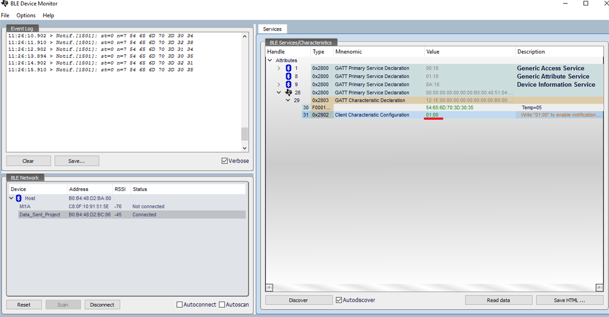

Hi All
I'm developing a program which sends timed strings of data upon a request. When using BLE Device Monitor it looks like attached image. When using a Host and BLE Device Monitor I can send request to board by writting "01:00" in Client Characteristic Configuration field. How would i do this without a host, using an automatic connection in second board? What message the requesting board would have to send (to connected sender) in order to enable notifications(the strings of data)?
Thank you,
Rui Costa;
I have 2 SmartRF06 Ev Boards and I'm using CCS7.
