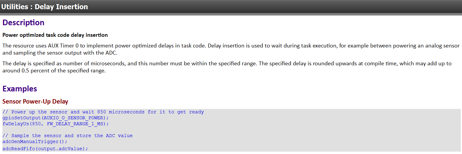

Someone can tell if it is possible to implement some kind of delay function in SCS? I want to implement a delay between some instructions in the execution code. If it is possible please tell me what to use.
