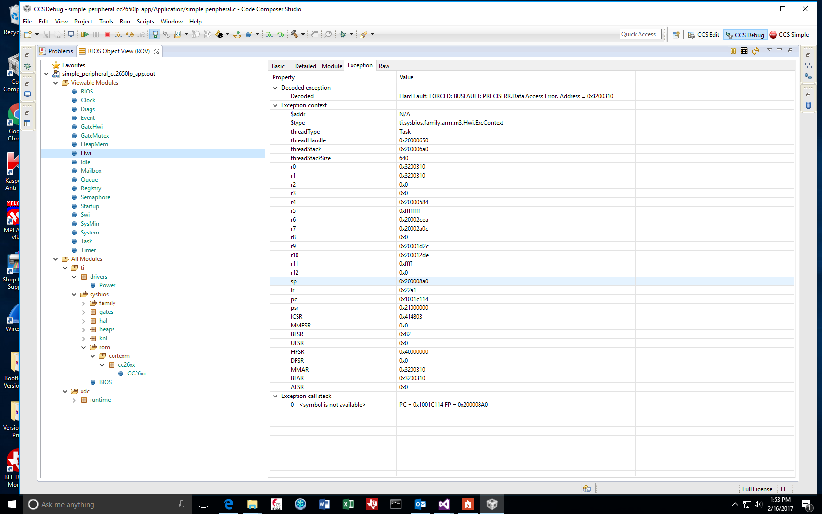

The ADC driver by itself is working fine in the application. When the UART is used,
(only for sensor calibration, with communication to an external processor), the sensor
reaches a hard fault exception and fails to communicate properly through the UART
(screenshot attached).
When the UART is in use, I'm wondering if the ADC driver is being accessed without
being powered on causing this exception.

    To simplify debugging, I am trying to use the UART on the sensor with
    ble_sdk_2_02_01_18; but without opening or using the ADC driver.
    I am seeing the same problem with the sensor (screenshots attached).
    Is this a problem with the stack sizes after the stack upgrade? Which
    task stack size should I increase and how?
    FYI-- I am working under the assumption my board file set up is OK.
    I am using the same directory structure as the  CC2650_LAUNCHXL
    with the board files edited to reflect the custom board pins.  Let me
    know if a board file review will help, I will upload it. (The pin to
    schematic mapping has been checked many times, this is not what I
    want checked here).
    Priya
  • I followed the steps from SWDG 9.8.2 to decode this exception. The
    decoded symbol is not available. I also increased the gapRole_taskFxn
    task size slightly, so the task module in ROV is not showing any stack
    peaks being reached.
    This exception does not happen with the use of the UART in
    ble_sdk_2_02_00_31. This stack however does not have the ADC driver.
    Any pointers are much appreciated.
    Priya
  • The lr pointed to the following section in simple_peripheral_task_fxn:
    // If RTOS queue is not empty, process app message.
    while (!Queue_empty(appMsgQueue))
    sbpEvt_t *pMsg = (sbpEvt_t *)Util_dequeueMsg(appMsgQueue);
    if (pMsg)
    // Process message.
    SimpleBLEPeripheral_processAppMsg(pMsg);
    // Free the space from the message.
    ICall_free(pMsg);
    I added the HEAPMGR_Metrics preprocessor option. There was nothing
    in the global variables that indicated a problem. I did not have success
    calling internal functions like heapmgrSanityCheck() (could not get
    past compile errors).
    I will await pointers on what to do from here.
    Priya

  • FYI- I went through the exercise of creating an independent custom board directory
    with ble_sdk_2_02_01_18. The sensor is still not talking through the UART. The problem
    is still there some where.
    Priya

  • The problem resolved this morning. The RTOS queue (which processes the UART
    receive bytes) with the ble_sdk_2_02_01_18 seems to be slower than ble_sdk_2_02_00_31.
    Increasing the timeout between bytes fixed the problem. I will be back if I run into
    any other difficulty with the ADC.
    Thank you much,
    Priya
