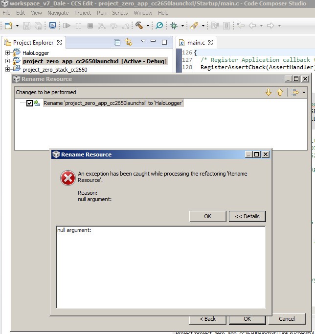

I am unable to rename my project that started out as a SimpleLink Academy ProjectZero.
There is no preview available when I right-click rename it (ccs 7.0.0.00042):
So, I continue with an 'OK' and get a 'nil argument' exception:
And when I click OK, the workspace is completely screwed up and I get this:
I click OK, and nothing works until I delete all three projects from workspace (including from disk) and re-import the project from my zipped archive.
Any ideas on this rename issue?
Dale

  • Hi JXS,
    Thanks, but to me Marie's answer of 'Please do not rename your project in CCS/IAR, but change the name in the .projectpec or .ewp or .project file.' was simply not enough. I had no idea what a .projectspec was (doesn't help that she misspelled it) and using those instructions would not even get the project folder renamed. Besides there is more to do if your project is a reference of another project.
    I was able to eventually rename enough things to make mine work and I could not even explain it all again.
    Someone need to write a book on how to rename all the folders, . files and references in them. To me I even had a question about whether I needed to rename in places where I ultimately decided not to because it was referencing what the actual source of the code was (I think).
    So, until I see that book, I will leave this unanswered ;)
