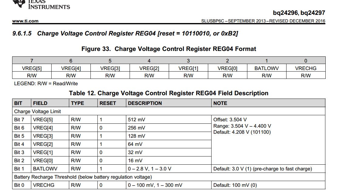

Want to operate the CC2640 using bq2497/6 battery charger
the Recommended Operating Conditions for VDDS, VDDS2, and VDDS3 when working with internal DC-DC is 1.8-3.8 Volts
the BQ24297 Vsys_Max is 4.35V.
how can I use the BQ24297 as a battery charger (Lithium-ion cell) and not exceeding the 3.8V CC2640 requirement?
