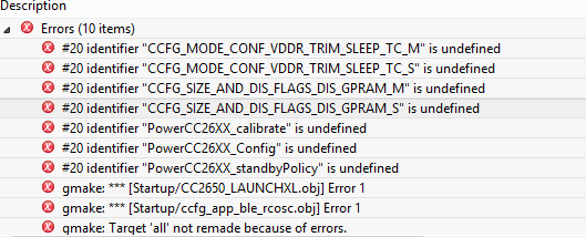

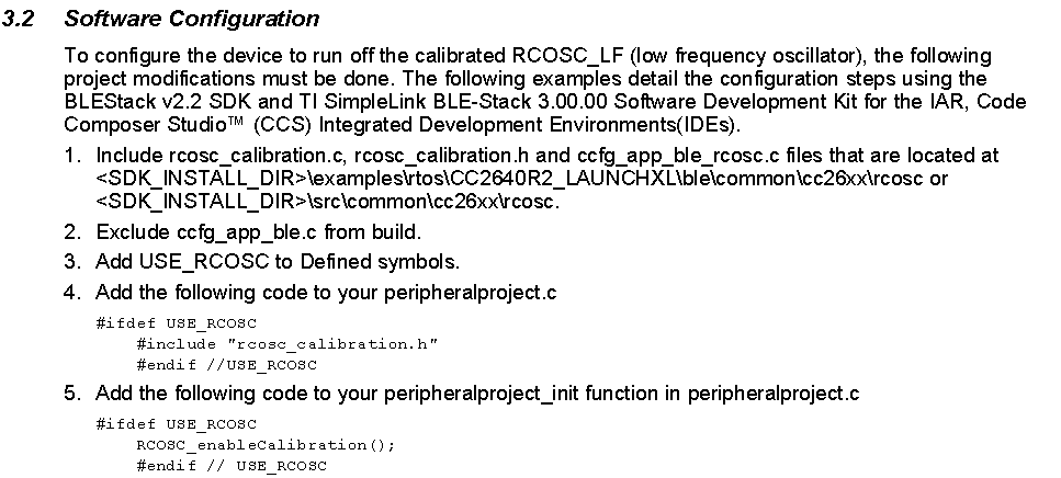

I'm working on CC2650 LP and tried to realized the working without 32 kHz functionality which would be used for my board. I followed the "Running Bluetooth® low energy on CC2640 Without 32 kHz Crystal" guidance, which is: \
However, when I got the following errors when I modified the Project_Zero_APP project:
1.Could anyone tell me how to set the correct configuration and enable RCOSC_LF?

  • Try to change the followings in the ccfg.c file to run CC2640 without 32kHz crystal
    // Clock settings
    // #define SET_CCFG_MODE_CONF_SCLK_LF_OPTION            0x0        // LF clock derived from High Frequency XOSC
    // #define SET_CCFG_MODE_CONF_SCLK_LF_OPTION            0x1        // External LF clock
    #define SET_CCFG_MODE_CONF_SCLK_LF_OPTION               0x2        // LF XOSC
    // #define SET_CCFG_MODE_CONF_SCLK_LF_OPTION            0x3        // LF RCOSC
    to
    // Clock settings
    //#define SET_CCFG_MODE_CONF_SCLK_LF_OPTION               0x2        // LF XOSC
  • Hello Jianlin,
    Did you add the files to your project and confirm they are in the application project's include path properties? This looks like a pre-processor failure.

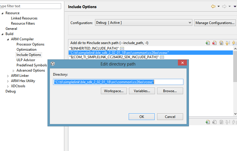

    1. I added the files to my project:
    2. And then I include the path of these files:
    3. I move these files to my startup folder:
    4. After I add the include code in my app and add the predefined symbol, I enable the following code in the board setting.
    5. However, I still got the following errors:
    Is there anything wrong with my including steps?
    Jianlin
  • I just built the changes with project zero for RCOSC and don't see these errors. The only change I had to make relative to the guide is to add:
    "${TI_BLE_SDK_BASE}/src/common/cc26xx/rcosc"
    To the app project's include paths so that it can see the 3 linked files. I added the files as links to the SDK.
    Can you try with a clean workspace? I used CCS v7.1 with TI Compiler v5.2.6.
    Best wishes

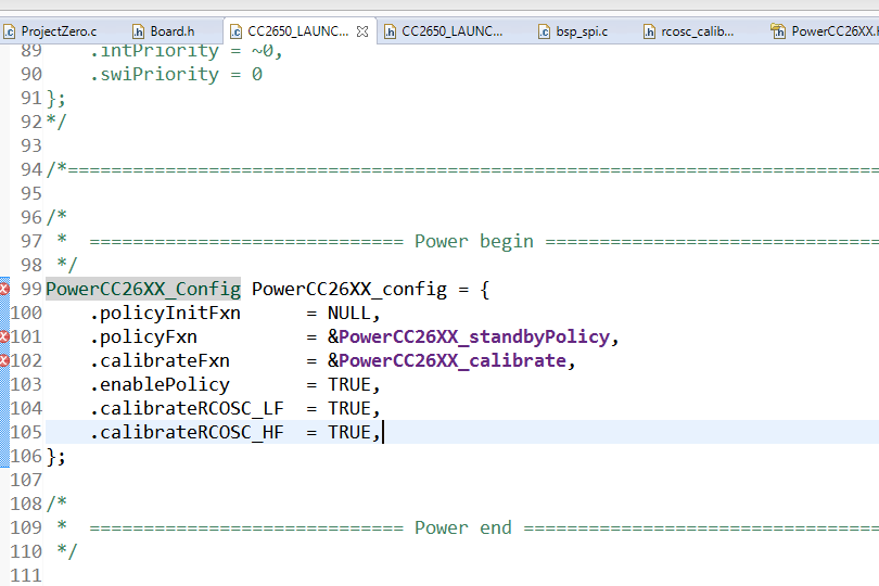

    Did you uncomment the following part which is commented in Board.h:
    Jianlin
  • This is in my CC2650_LAUNCHXL.c:
    * ============================= Power begin ==================================
    /* Place into subsections to allow the TI linker to remove items properly */
    #if defined(__TI_COMPILER_VERSION__)
    #pragma DATA_SECTION(PowerCC26XX_config, ".const:PowerCC26XX_config")
    #endif
    const PowerCC26XX_Config PowerCC26XX_config = {
    .policyInitFxn = NULL,
    .policyFxn = &PowerCC26XX_standbyPolicy,
    .calibrateFxn = &PowerCC26XX_calibrate,
    .enablePolicy = TRUE,
    .calibrateRCOSC_LF = TRUE,
    .calibrateRCOSC_HF = TRUE,
    I did not make any changes to Board.h
    Best wishes

  • Hello JXS,
    I found there are more than one version of project zero. The one I was used whose TI_BLE_SDK_BASE is linked to ble_cc26xx_2_01_00_44423_cloud folder. That could explain why the power section code in my CC2650_LAUNCHXL.c is commented.
    I tried to use your version and it worked.
