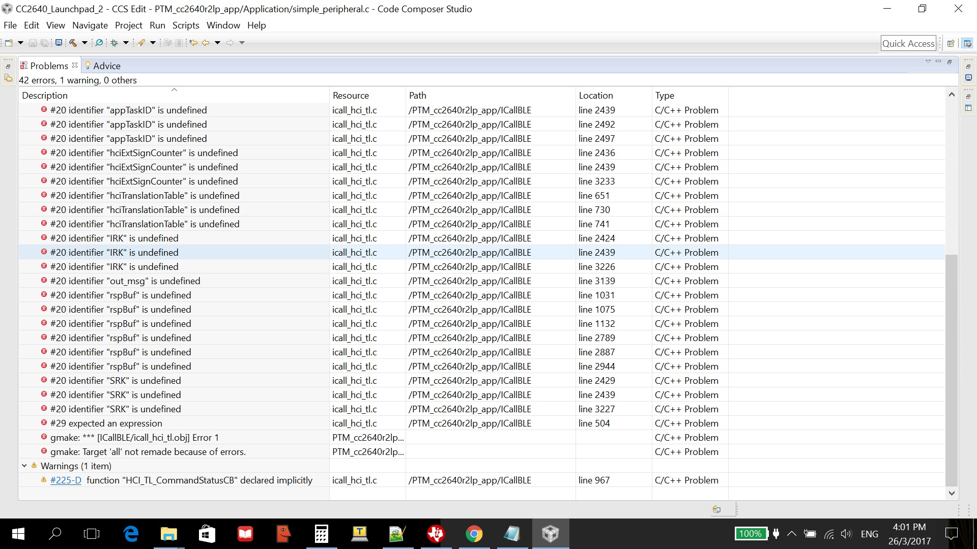

I am following the PTM Guide doc at simplelink_cc2640r2_sdk_1_30_00_25. I am encountering these errors below. I followed the PTM Guide as is. I triple checked everything I did. I also did clean rebuild and also rebuild index. But, still same errors. Please provide advice how to resolve these errors.
identifier "appTaskID" is undefined icall_hci_tl.c
identifier "hciExtSignCounter" is undefined icall_hci_tl.c
identifier "hciTranslationTable" is undefined icall_hci_tl.c
identifier "IRK" is undefined icall_hci_tl.c
identifier "out_msg" is undefined icall_hci_tl.c
identifier "rspBuf" is undefined icall_hci_tl.c
identifier "SRK" is undefined icall_hci_tl.c
- It seems that this is caused by not including HCI_TL_FULL or HCI_TL_PTM at predefined symbols. There is no mention at PTM guide to add HCI_TL_FULL or HCI_TL_PTM to predefined symbols. Do I add the HCI_TL_FULL or HCI_TL_PTM to predefined symbols?
expected a ")" simple_peripheral.c
// Register for Command Status information HCI_TL_Init(NULL, (HCI_TL_CommandStatusCB_t) SBP_sendToNPI, selfEntity);
I do not get where at the HCI_TL_Init() code line where the ")" is needed.
Warnings:
"HCI_TL_CommandStatusCB" declared implicitly icall_hci_tl.c
"HCI_TL_Init" declared implicitly simple_peripheral.c
"HCI_TL_SendToStack" declared implicitly simple_peripheral.c
Where is the header file for these 3 HCI C API's above.
