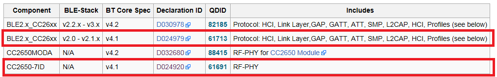

  • Hi, Fredrik-san.
    Thank you for reply.
    My customers are developing at the chip level of CC26xx.
    The following items are listed in the TI wiki.
    BLE2.x_CC26xx v2.2.x - v3.x v4.2 D030978 82185 Protocol: HCI, Link Layer,GAP, GATT, ATT, SMP, L2CAP, HCI, Profiles (see below)
    BLE2.x_CC26xx v2.0 - v2.1.x v4.1 D024979 61713 Protocol: HCI, Link Layer,GAP, GATT, ATT, SMP, L2CAP, HCI, Profiles (see below)
    CC2650MODA N/A v4.2 D032680 88415 RF-PHY for CC2650 Module
    CC2650-7ID N/A v4.1 D024920 61691 RF-PHY
    We recognize QDID for PHY as "CC2650MODA" and "CC2650-7ID".
    Because my customers are considering at the chip level of CC26xx,
    We thought we needed to use QDID "CC2650-7ID".
    but,
    I confirmed the certification contents of "CC2650-7ID"
    It was applied to "CC2650-71D", "CC2650-5XD", "CC2650-4 XS".
    www.bluetooth.org/.../QLI_viewQDL.cfm
    When considering at the chip level of CC26xx (ex : CC2650F128RGZR, CC2650F128RHBR, CC2650F128RSMR)
    Which QDID should I use?

  • Hi Hamada,
    You select the QDID that applies to the BLE Stack version you are using. The PHY QDIDs cannot be reused, you have to perform PHY qualification for your specific HW design.

  • Hi, Fredrik.
    I have not understood it yet.
    ●Customer's environment
     HW : CC2650F128RSMR
     SW : BLE Stack v2.1(BT 4.1)
    In this case, by using the QDID of "61691" and "61713"
    Is EPL (End Product List) registration possible?
    If not, how can EPL registration be possible?
    hamada
    You can use the "Protocol" QDID combined with 1) a pre-certified module's QDID such as the CC2650MODA, or 2) RF-PHY test evidence from your own custom HW board design to create an end product listing. I suggest using the services of a BQE - they will be able to handle all the paperwork, coordinate with your test lab to obtain the RF-PHY evidence, and finally issue the EPL.
