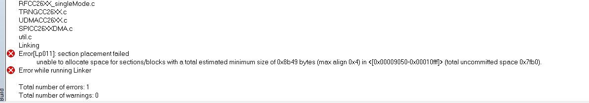

    I want to use SNV with OAD service. I performed write/read on SNV in simple_perpheral_app_lp but it returns status = 2.
    Then i checked the pre-processor of stack ( 2.2.1) and i found OSAL_SNV=0. That means no page is allocated for SNV. I changed OSAL_SNV  to OSAL_SNV=1 and also tried OSAL_SNV=2.
    But when i compiled the application I got following error.
    I checked the SNV with simple_peripheral (without OAD) and it works fine. I am working with IAR 7.70.2 and stack 2.2.1.
    Can you please help how i can enable the SNV along with OAD on chip ?

  • Use of SNV and/or Bond Manager with on chip OAD for CC2640 is not supported due to flash size limitations. I recommend you use CC2640R2F for this configuration.
    Best wishes
    As stated in the OAD guide, OSAL_SNV=0 and no GapBondMgr functionality are built into ImageA for BLE-Stack v2.2.1. There is likely not enough space to perform this functionality, this is why the image is failing to link.
    If you would like to be able to use ImageA with SNV and bonding please consider migrating to the CC2640R2F.

  • Sure, but there is no guarantee that this will actually work. Here is what I would try:
    1. Optimize the size of imgA, remove all code that is not absolutely necessary. This app is already pretty lean and trim, but maybe you can find a place to trim a few bytes here and there. From there, look at your map file and try to trim the space allocated to imageA. Once you can get imageA linking and building flash it
    2. Use the leanest stack configuration you can. Make sure you are peripheral only, no 4.1 controller, no extra features, etc. Re-build and re-flash the stack. To enable OSAL_SNV you will need to build the stack with OSAL_SNV=1 this requires around 4kB of additional memory.
    3. Try to optimize imageB to fit, but once you have set your stack size, your space for imageB is fixed. The only other thing you can tweak is your memory footprint within this space. (i.e. splitting sections, etc).
