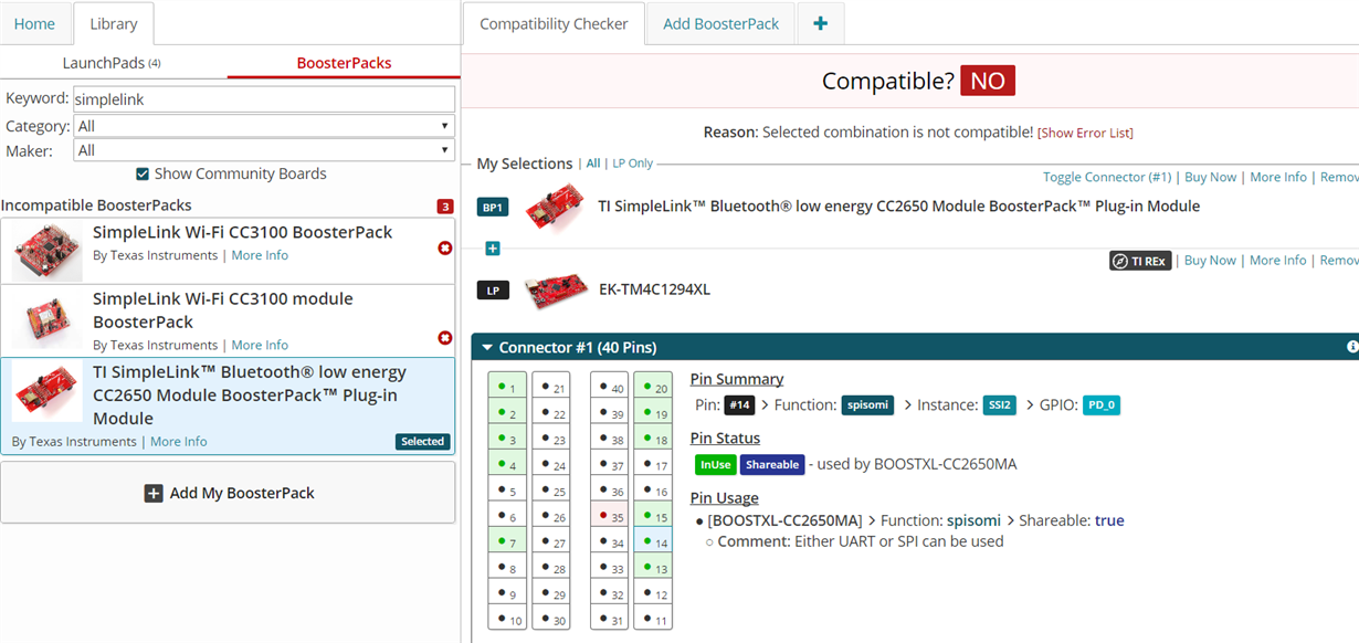

Part Number: CC2650
I want to know if
SimpleLink™ CC2650 MODA booster pack can be interfaced to Tiva Launch pad kit EK-TM4C1294XL
Thank you
Pavitra
Part Number: CC2650
I want to know if
Thank you
Pavitra
On the CC2650MODA pin# 35 is the reset input. This must be connected to and controlled by a GPIO on the LaunchPad. I assume pin# 35 on the Tiva LaunchPad can work as a GPIO also, not solely as PWM output.
