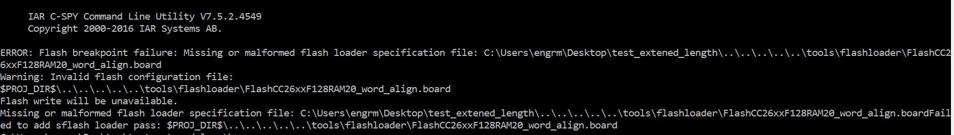

I want to flash cc2640 from command line. I am using cc2650lp_app.FlashROM.cspy  and using following command in bat script
cc2650lp_app.FlashROM.cspy my_file.hex --download_only
It downloads the file but script does ends automatically. Following is the output i got from running the above command:
I have also attached cc2650lp_app.FlashROM.cspy file.
But if i run cc2650lp_app.FlashROM.cspy directly from command line with same command it shows following.
Can you please help me how to use the cc2650lp_app.FlashROM.cspy to flash from bat script and exit the script after flashing?

    I'm not really familiar with IAR's generated C-SPY files, but the error message you get when running the command directly ("invalid flash configuration file") indicates that the project uses an invalid .board file, which you should look into. I'm guessing the IAR "xcl" file references this somewhere.
