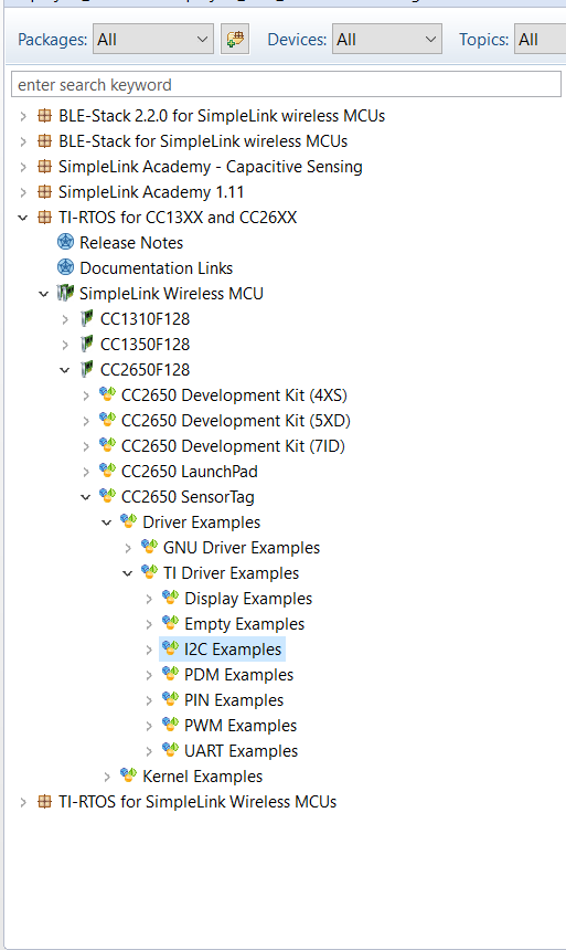

Hi
I would like to set up Tiva C Launchpad 1294XL to have access tp Blue tooth via LAUNCHXL-CC2650.. The I2C interface is preferred for the application in mind. Please give pointers on the same.
Are there examples or code to set up the I2C bus on Launchpad for CC2650
Thank you
  • You can find out of box example for I2C setup here :
    Even though the example code is on sensortag platform, but the code applies to all the different platform.
  • In addition please note there is no I2C slave driver provided for the CC26xx so you will need to implement the slave function on the TivaC. If you are establishing communication with another MCU, we recommend using UART or SPI as the communication bus.
