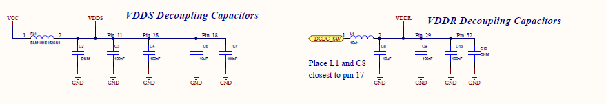

I am having problem with CC2640 hardware. The problem is that, sometimes the tag stops advertisement and it doesn't start advertisement again even after giving power cycle.
After investigation it was found out this issue is related discharging of capacitors, in order to verify this supply is removed for a longer time (i.e more than 30 sec) to allow all the capacitors to discharge. Once all the capacitors are discharged, and power is given to tag, it start working.
After further investigation it was found out that the VDDS decoupling 10uf capacitor (c6 in the following diagram) is causing the problem, so after removal of this 10uf capacitor, this advertisement issue is resolved
My question is that we have designed the circuit according to TI recommended schematic and this 10uf capacitor is recommended by TI, so therefore it is requested you to please check the design and let us know the issue guide us know the main issue.

    It sounds like you have a problem with that specific capacitor. For proper operation we recommend a 10 uF or 22 uF decoupling capacitor on VDDS. This has been used in all testing and characterization.

    We used TI recommended capacitor "CL10A106MQ8NNNC", this capacitor is working in one circuit and in another circuit it doesn't work. Can we remove this capacitor permanently from the circuit, will there be any consequences?

    I would not recommend removing the 10 uF decoupling capacitor. It is required for the DCDC and to handle the transients when turning on the radio.
    Why do you believe there is a problem with the capacitor? What measurements is this conclusion based on?

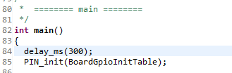

  • You can try to add a timer in main.c to delay the rest of the task and see if that helps.
  • Hello ,
    Thanks for your prompt response. I have already tried it, but i didn't work :(
    Sumair
  • Please use task_sleep instead of delay_ms.  so that the device can stay in low power state when it tries to boot.

    We recommend using a 22 uF capacitor when running off coin cell batteries, can you try changing C6 to 22 uF and see if that helps?

  • Hello Christine/Fredrik,
    I changed the code as you suggested but all in vain. Result is same.
