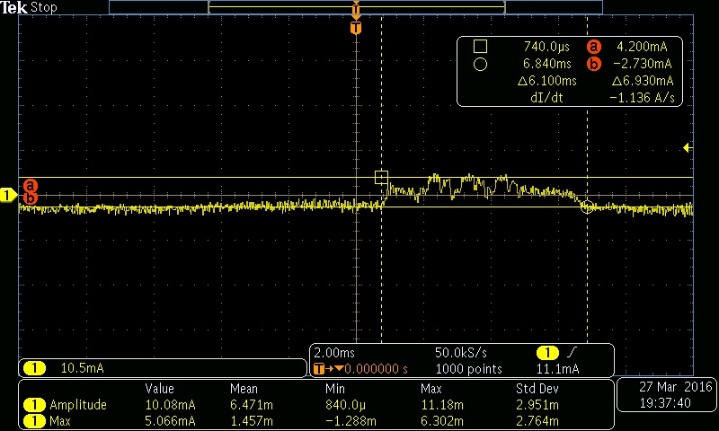

I have tested current consumption of BLE Tag (CC2640 based) using Oscilloscope and observed current consumption and transmission time (please see table below)

Please see the calculation below, I want to ask if the calculation is correct, please let me know if i miss anything in calculation
Battery Life Calculator
Select transmission power (dB) 0 dB
Instantaneous current durring transmission time (mA) 1.72 mA
transmission time (ms) 6.12 ms
Transmission interval (ms) 200 ms
Average current draw accounting for sleep [mA] 0.08152926 mA
Battery Capacity (mAh) 4800 mAh
Battery Life (years) 6 years 8 months

  • Your radio current looks pretty off.
    You can find the radio current in our datasheet : www.ti.com/.../datasheet
    We also have a power calculator for you to estimate current consumption of your application.
    Here is our application note about measuring BLE power consumption.
    http://www.ti.com/lit/pdf/swra478
  • Hello Christin,
    Radio is not turned off, please see attached waveform of 0dB. In attached waveform you can see the peak current is 6.9mA during transmission, the current (1.72mA @ 0dB) which I used is an average current
    I need to check if i am missing anything in my calculation, because i need to incorporate this calculation in my code.
    Other than TI calculator I found a "battery life calculator excel sheet" from TI forum, which I have also attached, I'd appreciate if you can check it also.

  • The excel sheet is a bit outdated, therefore I suggested you to use the power calculator. The power calculator can be combined with the application note I have attached. Then you will get what the old excel sheet provides.
  • Power calculator has 2 limitation
    1- Maximum Limit of Battery capacity is 4000mAh ( The battery we are using is 4800mAh)
    2- Only 2 options of battery voltage are available i.e 3.0V and 3.8V (The battery we are using is 3.6V)
    Can you please share me updated excel sheet or the calculation you are using in calculator so that i can use it according to my requirement.
    Sumair
  • You can take the numbers from the application note and renew the excel sheet(www.ti.com/.../swra478). We don't have the updated excel sheet. We input the most up to date numbers to the power calculator based on the application note.
    The standby current should be set to 1 uA instead of 1.49 in advertising.

    I have updated values in excel sheet but there was mismatch, so I had to included "-166 uSec.mA" factor in order to match with the TI calculator (highlighted with red color in attached picture).
    Please check and let me know if there is any mistake.
    Another question, In online calculator TI used battery voltage in calculation but in excel sheet there is no dependency of battery voltage. Can you please also check this?
  • The supply voltage will affect the CC26xx current consumption. You will have to check out the data sheet to update your radio current accordingly(ex : the TX/RX current vs VDDS can be found in page 28 in our data sheet, or you can fill out the excel sheet with the measurement you got from using oscilloscope). However, the process time for for every state would not change.
  • If BLE Tag is non-connectable then can I remove the following 3 process time and their consumption from calculation?
    1- Process 1: TX to RX transition
    2- Process 2: Receive (RX)
    3- Process 3: RX to TX transition
    Sumair
  • Yes, and then you can get the TX to TX transition time from the application note.
