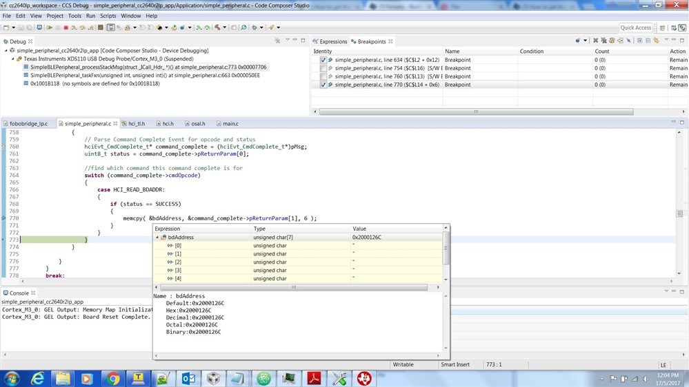

        I tried this code at simple peripheral but I am not able to get the correct BDA. What is the correct code to get the BDA?
    C Function: SimpleBLEPeripheral_init
    /* Hard code the DB Address till CC2640R2 board gets its own IEEE address */
      uint8 bdAddress[B_ADDR_LEN] = { 0x22, 0x22, 0x22, 0x22, 0x22, 0x5A };
      HCI_EXT_SetBDADDRCmd(bdAddress);
    C Function: SimpleBLEPeripheral_taskFxn()
    // Initialize application
      SimpleBLEPeripheral_init();
      // Application main loop
      for (;;)
        uint32_t events;
        // Waits for an event to be posted associated with the calling thread.
        // Note that an event associated with a thread is posted when a
        // message is queued to the message receive queue of the thread
        events = Event_pend(syncEvent, Event_Id_NONE, SBP_ALL_EVENTS,
                            ICALL_TIMEOUT_FOREVER);
        HCI_ReadBDADDRCmd();
    C Function: SimpleBLEPeripheral_processStackMsg()
    static uint8_t SimpleBLEPeripheral_processStackMsg(ICall_Hdr *pMsg)
      uint8_t safeToDealloc = TRUE;
      uint8 bdAddress[6+1];
        switch (pMsg->event)
            case GATT_MSG_EVENT:
              // Process GATT message
              safeToDealloc = SimpleBLEPeripheral_processGATTMsg((gattMsgEvent_t *)pMsg);
              break;
            case HCI_GAP_EVENT_EVENT:
                // Process HCI message
                switch(pMsg->status)
                    // Process HCI Command Complete Event
                    case HCI_COMMAND_COMPLETE_EVENT_CODE:
                        // Parse Command Complete Event for opcode and status
                        hciEvt_CmdComplete_t* command_complete = (hciEvt_CmdComplete_t*)pMsg;
                        uint8_t status = command_complete->pReturnParam[0];
                        //find which command this command complete is for
                        switch (command_complete->cmdOpcode)
                            case HCI_READ_BDADDR:
                                if (status == SUCCESS)
                                    memcpy( &bdAddress, &command_complete->pReturnParam[1], 6 );
            break;
            default:
            // do nothing
            break;
        return (safeToDealloc);
    The BDA read is 0x2000126C which is not the correct BDA.
    - kel
        I set a BDA to this below.
    uint8 bdAddress[B_ADDR_LEN] = { 0xAA, 0x55, 0xAA, 0x55, 0xAA, 0x55 };
        The  0x2000126C is a memory location. so I go to memory view and check the contents. This is what I get at location  0x2000126C. So, the BDA was copied to bdAddress[]. But, it is sort of weird how the BDA is being stored at memory location. Next I need to convert the hexadecimal value to string so I can print it out at Tera Term.
    - kel

  • Never mind my previous reply. The secondary MAC Address get erased when I do debug.
    From other post says the secondary MAC Address becomes the primary MAC Address if it is present in Flash.
    Problem solved.

                  hciEvt_CmdComplete_t* command_complete = (hciEvt_CmdComplete_t*) pMsg;
                  uint8_t   pktStatus = command_complete->pReturnParam[0];
                    case HCI_LE_READ_LOCAL_SUPPORTED_FEATURES:
                        if (pktStatus == SUCCESS)
                          uint8_t featSet[8];
                          // get current feature set from received event (bits 1-9 of
                          // the returned data
                          memcpy( featSet, &command_complete->pReturnParam[1], 8 );
                          // Clear bit 1 of byte 0 of feature set to disable LL
                          // Connection Parameter Updates
                          CLR_FEATURE_FLAG( featSet[0], LL_FEATURE_CONN_PARAMS_REQ );
                          // Update controller with modified features
                          HCI_EXT_SetLocalSupportedFeaturesCmd( featSet );
                          static uint8_t addr[6];
                          memcpy( addr, &command_complete->pReturnParam[1], 6 );
                          asm("NOP");
                      break;

  • Hi kel,
    Glad you have it working. Looks like you found and fixed the unneeded "&bdaddr" in the memcpy, no need to use double pointers here.
    Regarding why you don't see the 2nd BDADDR in Flash Programmer 2, calling HCI_EXT_SetBDADDRCmd does not program the flash memory and only sets the BD address in the Controller's local RAM until the next reboot. If you want to program the 2nd BDADDR, you must write the addr to the CCFG region in flash. See the Device Configuration section of the CC26xx TRM SWCU117.
    Best wishes
    PS: No need to blame the co-worker!
