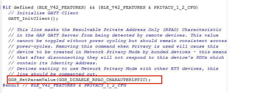

CC2640R2F: GGS_DISABLE_RPAO_CHARACTERISTIC caused >>> STACK ASSERT >> INTERNAL ERROR!
Part Number: CC2640R2F
I was trying to build the simple_peripheral_oad_offchip under ble5stack from SDK 1.35.00.33.
No code is changed. Functionally, it works fine. However, if the BOARD_DISPLAY_USE_UART_ANSI is disabled (by making xBOARD_DISPLAY_USE_UART_ANSI=1), the console shows:
>>>STACK ASSERT
***ERROR***
>> INTERNAL ERROR!
*BLE Peripheral B
0x98072DAA521E
Initialized
Advertising
I wonder if that is correct or not?
