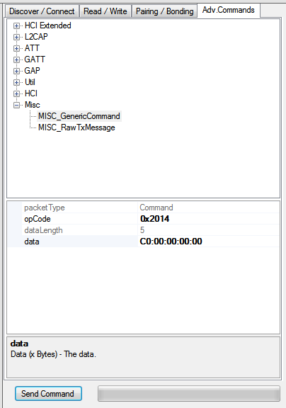

    It looks like I am getting a 0x12 return value for the HCI_LE_SET_HOST_CHANNEL_CLASSIFICATION command finished event. Any idea why I would be getting this based on what I am doing?
    2.18 INVALID HCI COMMAND PARAMETERS (0x12)

  • Hi JXS,
    FYI, I am able to read the channel map with the HCI_LE_ReadChannelMapCmd(connHandle); command. When the HCI_LE_READ_CHANNEL_MAP event comes in to SPPBLEClient_processCmdCompleteEvt() the channel map that is read is this:
    {0xFF, 0xFF, 0xFF, 0xFF, 0x1F}
    This is as expected, 37 bits on and the three MSb are off...
    Any thoughts to my previous question why I would be getting back an 0x12 error code from a HCI_LE_SetHostChanClassificationCmd(chanMap);?
    Tom
  • Hi Tom,
    I did confirm that the HCI_LE_SetHostChanClassificationCmd requires a minimum of two channels to be listed as 'unknown' or 1 in the channel map. This can be prototyped in BTool with a LaunchPad running the host_test firmware according to the following setup:
    Remember you must be a Central role and the command can only be sent during a connection. Also, as previously stated, I do not believe the test setup with this HCI API to be sufficient for regulatory testing.

    Regarding your previous post, you mentioned HCI_LE_ReadChannelMapCmd() - did you mean HCI_LE_SetHostChanClassificationCmd()?
    So the five-byte bitmask must have at least two bits as 1 - or two channels as 'unknown'? I cannot be exclusive to only one channel?
    Tom
  • Hi Tom,
    Sorry for the confusion, I did intend to state "HCI_LE_SetHostChanClassificationCmd" and have corrected the post.
    That is correct; you need to specify at lest two active channels (1's) in the chanMap.
