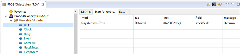

There is one pecularity: In RTOS Object View (ROV) I see "stackPeak" message "Overrun!". But actually, I always see this, even in well working systems.
Does anyone can give me some hints on where to start to track down this issue?

  • Hi Harald,
    From the TRM SWCU117, Radio chapter, Command Status error 0x87 equates to "ParError" with a description:
    "There were errors in the command parameters that are parsed on
    submission. For radio operation commands, errors in parameters
    parsed after start of the command are signaled by the command
    ending, and an error is indicated in the status field of that command
    structure."
    I've seen similar radio errors that were traced to memory corruption, usually in the heap / system RAM. These radio faults are usually a manifestation of an earlier memory corruption, not the root cause. For example, an application that writes to a pointer that was already freed in the heap could corrupt RAM that is subsequently fed into the RF core. The fact that you see this and some odd behavior during high throughput may be a clue to look into the heap and see if there is any corruption with your memory usage. We do not see this when we run our Throughput demos, so I don't see it originating in the stack.
    Best wishes
