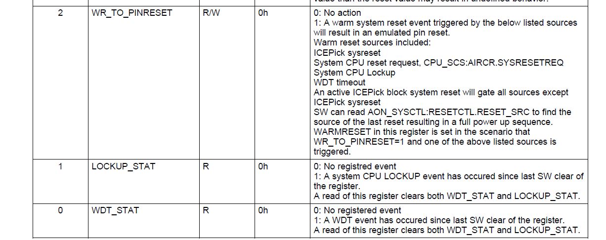

I am using cc2640 for my data logging application, and it seems to be getting resetted randomly. I came to know that the reset is WARM RESET.
The PRCM:Warmreset register shows 0x00000004  which means "WR_TO_PINRESET"  but I find it difficult to understand the description.
Can you help me understanding the description for "WR_TO_PINRESET"?
