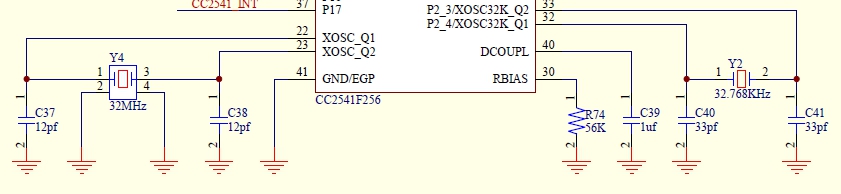

We have a CC2541 based design that uses a 32MHz crystal for external clock (Part #: SJKY7U32000M121050B10, manufactured by Shenzhen Crystal Technology). We have several 100's of these units deployed, but on a few units (3), we are seeing a weird problem. All these 3 units used to work perfectly fine, we were able to connect to them using our BT app and sustain the link and operate them. After a few weeks of working perfectly fine, these 3 units stopped communicating with the app and when we opened up the HW to debug, we narrowed it down to the 32MHz clock. The code is basically stuck in the following code snippet at startup:
#define START_HSOSC_XOSC() \
SLEEPCMD &= ~OSC_PD; /* start 16MHz RCOSC & 32MHz XOSC */ \
while (!(SLEEPSTA & XOSC_STB)); /* wait for stable 32MHz XOSC */ \
The code is stuck in while() loop because there is no stable 32MHz clock (it is flat). We looked at the XOSC_Q2 output from the cc2541 chip and it is flat at 3.3V.
When we change the code to use the internal 16MHz instead of external 32MHz clock, units are alive again, so we have very high confidence that the problem is somewhere in the closed loop 32MHz circuitry or in the software that drives this loop
Since the units used to work properly, we are hesitant to conclude that this is a HW (crystal/chip) problem. At the same time we are at a loss as to what SW could do to cause 32MHz clock to be flat.
Appreciate any help/hints/guidance that could help us resolve this issue.
Yohannes

  • BTW Fredrik, sending the schematic snippet showing the 32MHz and 32kHz crystal circuits used with the cc2541 chip. Just in case there's some kind of hint there.
    Yohannes

    We have more information that might shed some light on this issue and wanted to run it by you. Specifically we've learned that when the system gets into the bad state, the output from the CC2541 chip on XOSC_Q2 gets stuck into a "low resistance to ground" state (about 10 ohms), which prevents this pin from ever being driven high to the external crystal to start the oscillator, and the chip gets stuck in a while loop waiting for the XOSC to power up.  This low resistance state persists regardless of whether the system is powered on or off. When we measure this resistance on a "normal" board that doesn't have this problem we get something like 4 Megaohms. The only way we've found to get the system out of the bad state is to desolder, remove, and then re-attach and re-solder the external 32 MHz crystal. When we measure the resistance to ground on the XOSC_Q2 pin after removing the external crystal see 4 megaohms. When we put back the crystal - still see 4 megaohms. We have no idea why removing and re-attaching the crystal fixes the problem, but we've confirmed this on two separate boards that had this problem.
    Questions:
    • Does any of this sound familiar to you? We are seeing symptoms like this (i.e., CC2541 not able to boot) in about 2% of the several hundred units we have in the field.
    • Is there any path in the loop that could cause the Q2 output to be connected to ground permanently? For example could the external crystal path be permanently powered down?
    • We have read SLEEPCMD.OSC_PD and SLEEPCMD.PWR_MODE(1:0), they are both set to 0, so XOSC is not powered down from there. Is there any other possible path that could cause a low resistance path of XOSC_Q2 to ground?
    • Any ideas for a potential workaround? We've thought of using the CLD (clock-loss detection) register - might it have additional logic that corrects this issue during a CLD-induced reset?
    Yohannes
  • Hi Yohannes,
    I have never seen this problem with any of our CC25xx devices before. To me it sounds like a crystal defect, especially since the impedance jumps back to the correct value as soon as the crystal is removed from the circuitry. Have you contacted the crystal manufacturer in addition to posting here?
    If you can get devices to consistently fail, it would be interesting to try mounting a different crystal part and see if that remedies the situation.
    Fredrik
